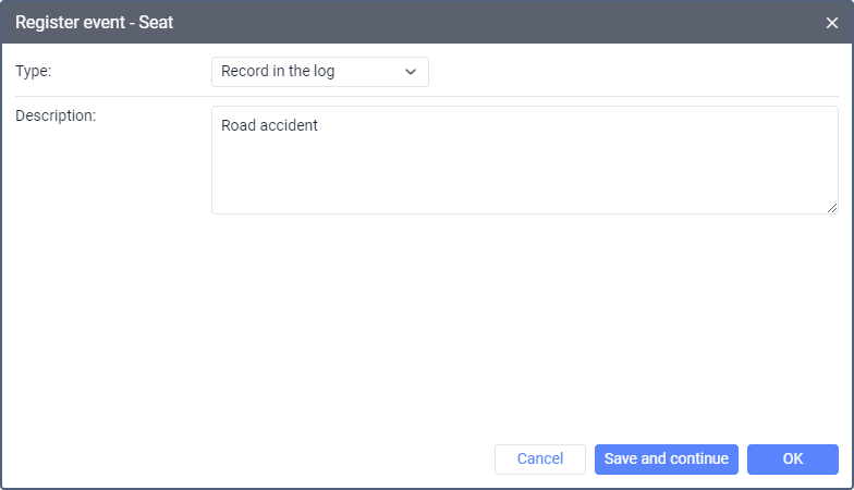

Record in the log
Select this type to make a record of any kind in the unit log. It is saved as a custom record with the indication of its creation time.
You can see the registered records in the messages of the Log type and in the report table of the same name.

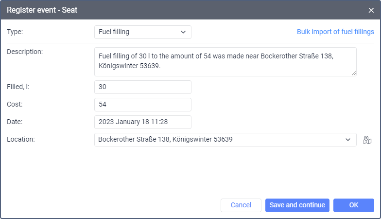

Fuel filling
Select this type to register a fuel filling for the unit, including data on its volume and cost. If a fuel level sensor is configured for the unit, you can compare the specified volume data with the sensor readings in the Fuel fillings and battery charges report.
To register a fuel filling, specify the following parameters:
ParameterDescription
Description
The information about the fuel filling. By default, this field shows a text to which the filling volume and cost values are automatically added when you specify the parameters below. You can edit the description if necessary.
Filled
The volume of the filled fuel. Fractional values (to the nearest hundredth) are allowed. Use a dot as a separator.
Cost
The cost of the filling. Fractional values (to the nearest hundredth) are allowed. Use a dot as a separator. For example, to register a cost of 77 dollars 88 cents, enter 77.88.
Date
The date and time of the filling. You can specify it using the calendar. The current date and time are shown by default.
Location
The place where the vehicle was refuelled. You can specify it in the same way as for a custom event.
The registered fuel fillings are displayed on the Tasks tab and in the following report tables: Events, Fuel fillings, Utilization cost, Chronology.
If you have a CSV or XLSX file with information about several fuel fillings, you can import them into the system at the same time. To do this, click Bulk import of fuel fillings and follow the steps described in the Import from CSV/XLSX section.
