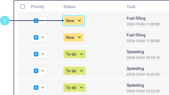

Changing the task status
After the event is registered, the task appears in the list of tasks with the New status. You can change the status of one task or several tasks at once.
To change the status of a single task, follow the steps below.
  1. Click on the field in the Status column.
  2. Select one of the available options:
    • new;
    • to do;
    • in progress;
    • done;
    • paused;
    • rejected.
  3. If you selected Done, Paused or Rejected, leave a comment. Comments are also required when changing the task status from Done or Rejected to any other. Comments are limited to 500 characters.**
  4. Click OK.
You can also change the status and leave or edit a comment in the task information.
