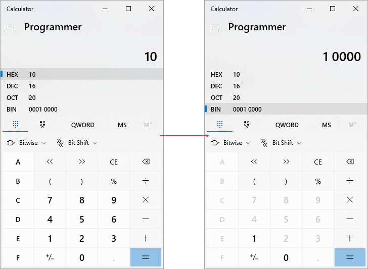

The data on digital inputs and outputs is usually presented in messages in the following format: I/O = 0/0, where I stands for input and O for output. If I/O = 0/0, all bits (inputs and outputs) are inactive. If the value of I or O is not zero, an input or an output is activated. To find out which one, you should convert a hexadecimal number to binary and determine the bit number as in the example below.
Example
Let’s say, a message with the parameter I/O = 10/0 was sent from a place where the ignition was on. To determine the bit number (in this case, the input), you should enter the received value, that is, 10, in the calculator in hexadecimal mode (HEX), and then switch to binary mode (BIN). In the given example, the resulting binary number is 10000. Now you should determine the position of number 1 counting from the end. In our case, number 1 is the fifth from the end, which means that the ignition sensor is connected to the fifth port. Therefore, the parameter of the ignition sensor should be in5 (digital input 5).
If the device ports are numbered from zero, and not from one, then the N value in the inN and outN parameters is one more than the real port number.
