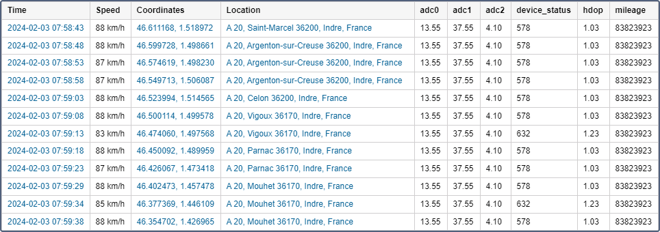

Messages tracing
The main objective of the Message tracing table is to facilitate the work with the parameters from the messages. That is why the parameter values are presented not as a single data array but have a particular structure. It means that every parameter is located in its own column.
Along with the parameter values, the Message tracing table can include other columns described below.
Column Description
Time The date and time when the message was sent.
Speed The speed of a unit from the received message.
Coordinates The coordinates of the unit.
Location The location of the unit at the time when the message was sent.
Value The value of the parameter sent in a message. If the parameter value contains the characters that the system can’t decode, then is displayed in the report instead of them, and a dash (-----) is shown instead of the value when you export the report to an XLSX file.
If the numerical value of the parameter sent by the sensor exceeds 53 bits (9,007,199,254,740,991), the accuracy of displaying this parameter in the interface and reports is reduced starting from the lower bits. However, such values can be processed, for example, by bitwise control or used for sensors with bitwise control.
Driver The name of the driver (if available).
Trailer The name of the trailer (if it was assigned).
Notes An empty column to add your custom comments after printing or exporting the report.
Video Video files received from the unit.
Image The images received from the unit. Viewing images in reports and the functions available while doing this are described here.
Note that you can click on a link in such columns as Time, Coordinates and Location to view the position of a unit on the map.
This table cannot be generated for unit groups.
