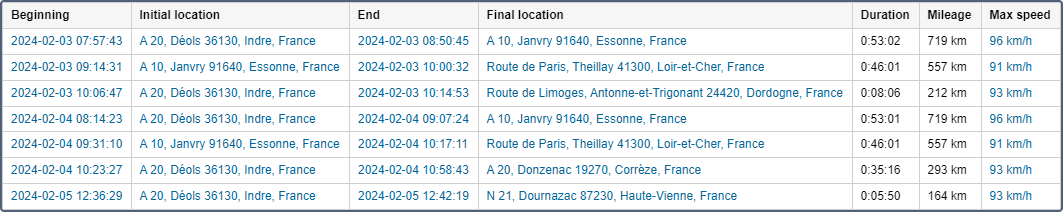

Trips
The Trips table shows the intervals of movement with the indication of time, location, and other parameters such as speed, mileage, fuel, and many others. The intervals of movement (trips) are detected according to the parameters set on the Trip detector tab and adjusted for each unit individually.
The Trips table can include the columns described below.
Column Description
Beginning The date and time when the trip began.
Initial location The address where the device was at the beginning of the trip.
Initial coordinates The geographical coordinates of the location of the unit at the beginning of the trip (in decimal degrees).
End The date and time when the trip ended.
Final location The address where the unit was at the end of the trip.
Final coordinates The geographical coordinates of the location of the unit at the end of the trip (in decimal degrees).
Driver The name of the driver (if assigned).
The grouping rows (group headings) show the name of the driver assigned at the beginning of the first interval of the grouping.
Trailer The name of the trailer (if assigned).
The grouping rows (group headings) show the name of the trailer assigned at the beginning of the first interval of the grouping.
Passengers count The number of passengers transported within a trip.
Duration The time interval of the trip.
