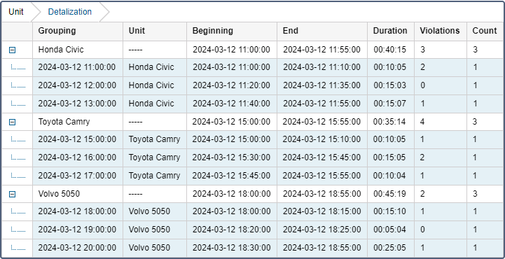

Assignments
The Assignments table shows when and to which unit the driver was assigned, how long their work shifts lasted, how much fuel was spent, the distance travelled, etc.
The table can include the columns described below.
ColumnDescription
UnitThe name of the unit to which the driver was assigned.
DriverThe name of the assigned driver (only in the report on the group of drivers).
BeginningThe date and time when the driver was assigned to the unit.
Initial locationThe initial position, that is, the address at that moment (if available).
EndThe date and time when the driver was separated from the unit.
Final locationThe final position, the address at that moment (if available).
DurationThe duration of a work shift.
Total timeThe time from the beginning of the first shift to the end of the last shift.
Engine hoursThe total amount of engine hours for a working interval of the driver.
Engine hours in movement
The number of engine hours for the interval of movement with the assigned driver.
The movement is considered those intervals in which the speed value was greater or equal to the one from the Min moving speed field in the trip detector.
Engine hours in idle runThe number of engine hours for the interval of idling with the assigned driver.
MileageThe distance travelled within the period.
Mileage (adjusted)The mileage taking into account the coefficient set in the unit properties on the Advanced tab.
Urban mileageThe distance travelled at low speed.
Suburban mileageThe distance travelled in the suburban area (at high speed). It is calculated in regards to speed. The urban/suburban speed line is indicated on the Advanced tab (the Urban speed limit setting).
Avg. speedThe average speed on a given interval.
Max. speedThe maximum speed registered within this work shift.
CounterThe value of the counter sensor.
StatusThe status of the unit registered during the interval (if there are several, the first one is displayed).
ViolationsThe number of violations.
CountThe number of assignments found on a given interval.
Fuel consumedThe amount of fuel consumed in total for all fuel sensors.
Consumed by ImpFCS/AbsFCS/InsFCS/FLS/math/math for FLS/ratesThe volume of consumed fuel detected by any fuel sensor (such as impulse/absolute/instant fuel consumption sensor, fuel level sensor) or calculated by math or rates.
Energy consumedThe amount of consumed battery energy in kWh calculated using the readings of the battery level sensor for the interval during which the driver was assigned to a unit.
Avg. fuel consumptionThe average fuel consumption, determined from the available fuel sensors.
Avg. consumption by ImpFCS/AbsFCS/InsFCS/FLS/math/math for FLS/ratesThe average fuel consumption in the trip detected by one of the methods mentioned above.
Avg. energy consumptionThe average battery consumption in kWh per 100 km or mi calculated using the readings of the battery level sensor during the interval when the driver was assigned to a unit.
Initial fuel levelThe fuel level at the beginning of the work shift.
Final fuel levelThe fuel level at the end of the work shift.
Initial battery levelThe battery level in kWh at the beginning of the interval during which the driver was assigned to a unit.
Final battery levelThe battery level in kWh at the end of the engine hours interval during which the driver was assigned to a unit.
PenaltiesThe penalties calculated for the adjusted Eco driving criteria.
RankThe penalty points, converted into a grade using a 10-point rating system.
In addition, on the Bind tab of the report template, you can select the units to which the report should be applied. If no units are selected in this section, the report will be applied to all available units.
The Assignments table is designed in such a way that the first column is the list of units to which the driver was assigned. It is recommended to apply the detalization option to this table to get a possibility to expand any unit and see more detailed information about all work shift.
To determine the intervals of the assignment, the messages from the unit are also taken into account. If there are such messages, they are considered to be of more priority than the messages about the assignment (the intervals are counted according to them).

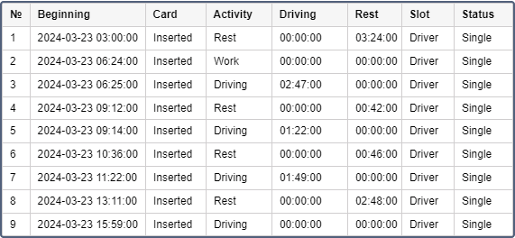

Driver activity
The Driver Activity table shows such information as the type of driver’s action, the crew of a vehicle, the state of the tachograph cards. It can include the columns described below.
ColumnDescription
BeginningThe date and time when the activity begins.
CardThe state of the digital tachograph (inserted/not inserted).
ActivityThe type of driver's activity (rest, work, driving, available, not available).
SourceThe source of data, which is used to generate information about driver activity. The following column values are available: E — the data about trips is used; T — the tachograph data is used; U — the data about driver separation is used; None — the data source is unknown.
UnitThe name of the unit to which the driver is assigned.
DrivingThe time of driving.
WorkThe hours of active work (time spent by the driver on vehicle repair, fuel filling, etc.).
AvailabilityThe hours of passive work (time spent by the second driver in the moving vehicle).
RestThe time for rest of the driver (vehicle is stopped, the driver rests in a specially designated place).
Overall workThe total time spent by the driver on such actions as driving, work, reserve.
SlotThe slot for digital tachograph card (driver or co-driver).
StatusThe vehicle crew size (single/crew).
Daily mileageThe distance covered by the assigned driver during the day (24 hours).
The last row of the table shows 0:00:00 instead of the duration value for all activity types, because the end time of the driver’s activity is unknown, regardless of the selected data source.

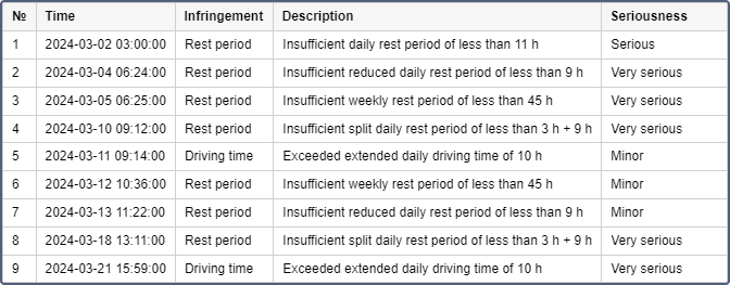

Infringements
This table shows the information on the violations of labor routine by the driver. The violations are determined in accordance with the AETR regulations.
ColumnDescription
Time
The date and time of the infringement registration.
If the driver has been driving for 6 hours or more, the infringement is registered at the moment when driving, excluding work, has lasted 6 hours (+/- 1 minute) from the start of movement. Such an infringement is considered very serious. If the driver has been driving for 5 to 6 hours, the infringement is registered at the moment when driving has lasted 5 hours, and if they have been driving for 4.5 to 5 hours, the infringement is registered at the moment when driving has lasted 4.5 hours. Such infringements are considered serious and minor, respectively.
Thus, if you run the report for today twice, you may get different data on the last infringement of driving duration. For example, if the driver has managed to drive 4 hours and 40 minutes by the first report execution, and 5 hours by the second, then the infringement registration time and seriousness in the first and second reports will differ. At the same time, regardless of the seriousness degree, the description “Exceeded uninterrupted driving time of 4 h 30 min” is displayed for such infringements.
InfringementThe type of driver's activity the conditions of which have been violated.
DescriptionA short description of the infringement.
SeriousnessThe extent of the infringement.
CountThe number of violations. If the grouping option is activated, this column shows the total number of violations for the selected interval.

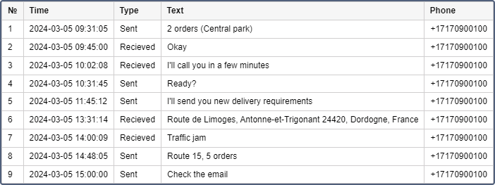

SMS messages
This table shows the correspondence of the dispatcher with the driver via SMS. The dispatcher (operator) can send messages to the driver from the Wialon interface through a special SMS window. The driver sends messages from their mobile phone. This mobile phone number must be indicated in the driver’s properties.
This table is available only for reports on a group of drivers.
The columns that can be included in the table are listed below.
ColumnDescription
TimeThe date and time when the message arrived.
TypeThe message type: sent (message sent by the dispatcher) or received (message received from the driver).
TextThe text of the message.
PhoneThe phone number of the driver.
Modem phoneThe phone number of the modem that sent/received an SMS.

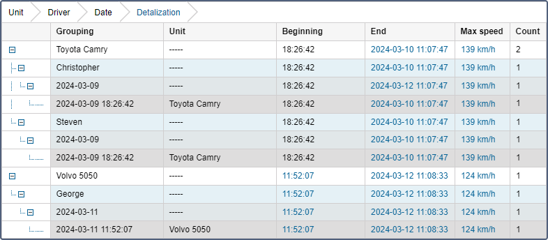

Trips
The Trips table displays the location, duration, speed, and other parameters. It can include the columns described below.
ColumnDescription
BeginningThe date and time when the trip began.
Initial locationThe address where the device was at the beginning of the trip.
Initial coordinatesThe geographical coordinates of the location of the unit at the beginning of the trip (in decimal degrees).
EndThe date and time when the trip ended.
Final locationThe address where the device was at the end of the trip.
Final coordinatesThe geographical coordinates of the location of the unit at the end of the trip (in decimal degrees).
DriverThe name of the driver assigned to the unit (only in the report on the group of drivers).
UnitThe name of the unit used in the trip.
TrailerThe name of the trailer (if assigned).
DurationThe time interval of the trip.
CO2 emissionsThe amount of CO2 emissions during the trips. It is calculated by multiplying the value in the Mileage column by the value specified on the Profile tab in the unit properties.
Engine hoursThe time of the operation of engine hours during the trip.
MileageThe distance travelled during the whole trip.
Mileage (adjusted)The mileage taking a coefficient set in unit properties (the Advanced tab) into account.
Urban mileageThe distance travelled in the urban area.
Suburban mileageThe distance travelled in the suburban area (i.e. at high speed). The urban/suburban speed line is indicated on the Advanced tab (the Urban speed limit setting).
Avg speedThe average speed within the trip.
Max speedThe maximum speed registered within the interval.
Trips countThe number of completed trips.
ConsumedThe volume of consumed fuel detected by any sort of fuel sensor. If several such sensors are available, their values sum up.
Consumed by ImpFCS/ AbsFCS/InsFCS/FLS/math/math for FLS/ratesThe volume of consumed fuel detected by a fuel sensor (such as impulse/absolute/instant fuel consumption sensor, fuel level sensor) or calculated by math or rates. More information about fuel in reports can be found here.
Rates deviation by ImpFCS/ AbsFCS/InsFCS/FLSThe difference between consumed fuel detected by a sensor and consumption rates. If a number in this cell is negative, it means the detected consumption does not exceed the indicated rates.
Avg consumptionThe average fuel consumption by any sort of fuel sensor. If several such sensors are available, their values sum up.
Avg consumption by ImpFCS/ AbsFCS/InsFCS/FLSThe average fuel consumption during the trip detected by one of the methods mentioned above.
Avg consumption in idle run by ImpFCS/ AbsFCS/InsFCS/FLS/math/math for FLS/ratesThe average fuel consumption during the idle run.
Avg mileage per unit of fuel by ImpFCS/ AbsFCS/InsFCS/FLS/math/math for FLS/ratesThe average fuel consumption (per one liter/gallon) detected by one of the methods mentioned above.
Initial fuel levelThe fuel level at the beginning of the trip.
Final fuel levelThe fuel level at the end of the trip.
Max fuel levelThe maximum fuel level during the trip.
Min fuel levelThe minimum fuel level during the trip.
RankThe received penalty points converted into a grade using a 10-point scoring system.
Avg value of custom sensorThe average value of a custom sensor during the trip.
Min value of custom sensorThe minimum value of a custom sensor during the trip.
Max value of custom sensorThe maximum value of a custom sensor during the trip.
Initial value of custom sensorThe custom sensor value at the beginning of a trip.
Final value of custom sensorThe custom sensor value at the end of a trip.
