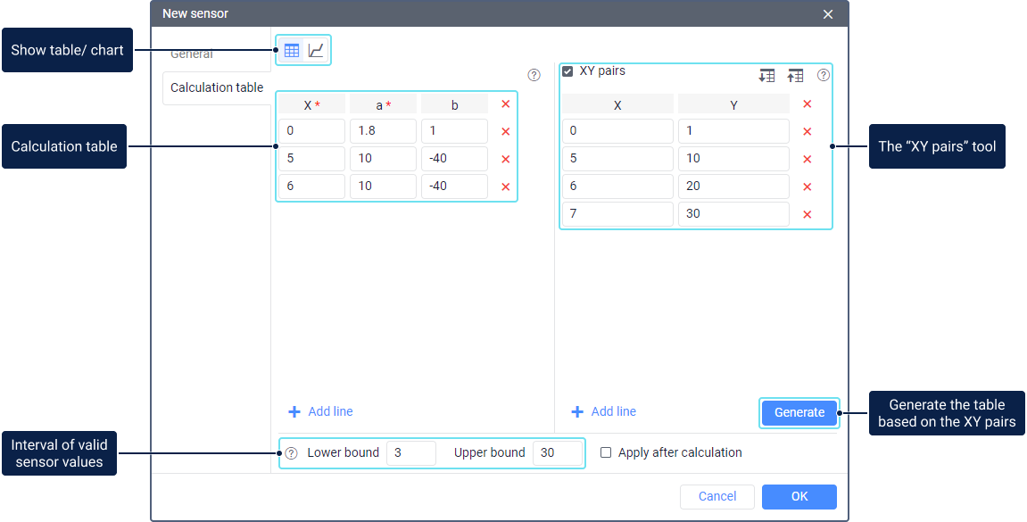

The tab is divided into two parts: on the right, you can see the XY pairs tool, and on the left, the calculation table consisting of columns with values X, a, and b. If necessary, you can see the calculation result in the chart.

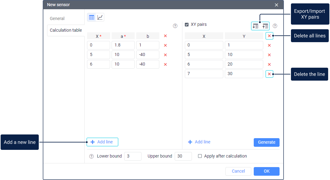

Working with the table
To add a new line to the table, click Add line (). To delete a line, click on the icon next to it. To delete all lines at once, click on the icon in the table heading and confirm the action in the window that opens.

In the Lower bound and Upper bound fields, you can specify the interval of valid sensor values. All received values which go beyond the specified interval are considered invalid. The specified lower bound is included in the interval of valid values and the upper one is not. Invalid values are not considered to be equal to 0.
If the Apply after calculation option is enabled, the specified bounds are applied to the processed values Y. If this option is disabled, the bounds are applied to the raw values X.

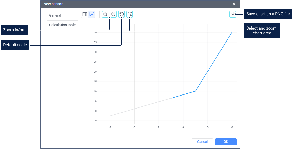

Working with the chart
To see the calculation result in the chart, click on the icon   above the table.
Using the icons above the chart, you can perform the following actions:
IconAction
Zoom in/Zoom out twice the previous scale. You can also change the scale using the scroll wheel.
Show the chart at the default scale that makes visible all values entered in the table. Instead of using this icon, you can double-click anywhere inside the chart.
Select and zoom in on an area of the chart. To do this, click on the icon and select the required area while holding the left mouse button.
Save the visible area of the chart to a PNG file.
If no value limits are specified, the calculation chart extends along the X-axis to the right and left. This is due to the fact that the values in the first interval also influence all values from minus infinity, and the values in the last interval, all values up to plus infinity.

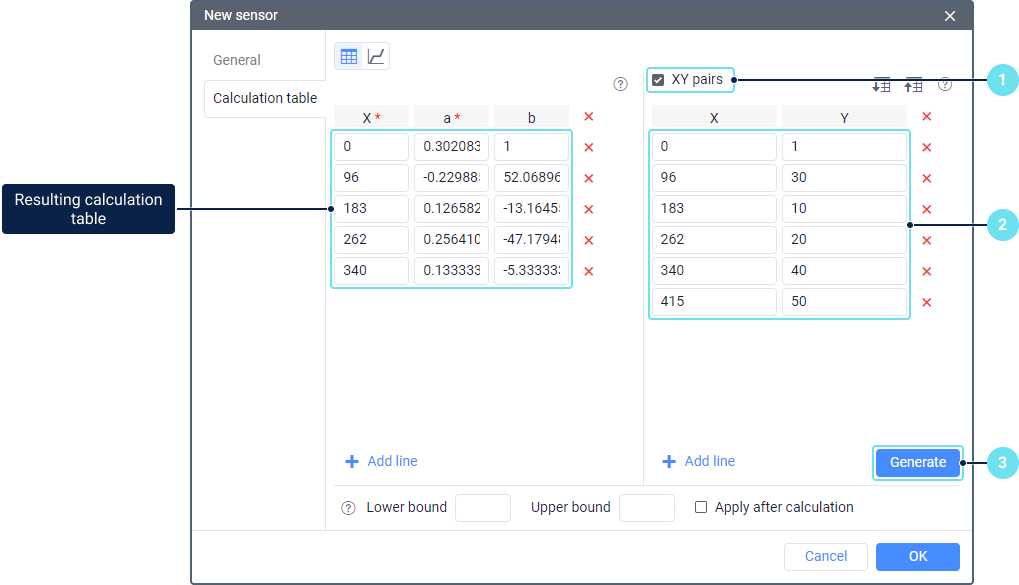

XY pairs
The XY pairs tool is designed to fill in the calculation table automatically. You can use this tool when calibrating sensor values experimentally. For example, you can pour different volumes of fuel into the tank and take the readings of the fuel level sensor corresponding to these volumes. See more information on how to make the calibration of a fuel tank in the guide.
To add the XY pairs and fill in the calculation table automatically, follow the steps below.
  1. Activate the XY pairs tool.
  2. Specify the input value X (for example, the fuel level sensor value), and the corresponding output value Y (for example, the fuel volume at which this value was received). Add the required number of lines.
  3. Click on the Generate button.
On the left, the calculation table is generated automatically in accordance with the specified values. The table shows one line less than added in the XY pairs. All changes made in the calculation table manually don’t influence the values specified in the XY pairs.
In the calculation table, the value a and the displacement b are calculated by the system in the following way:
  • a is calculated by the formula ∆Y / ∆X. The displacement along the X- and Y-axis is calculated separately for each interval, then the displacement along the Y-axis is divided by the displacement along the X-axis.
  • b is calculated by the formula b = Y−a × X.
To the right of the XY pairs tool, the following icons are available:
  • . Allows you to export the values of the added XY pairs to a CSV file.
  • . Allows you to import values from CSV or TXT files.
