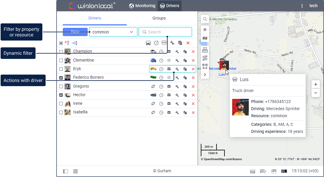

To quickly find the required driver, use the following filters:
  • filter by property (assigned or not assigned drivers) or by resource,
  • dynamic filter by driver name, phone or code.
Tooltip content
In a driver tooltip, you can see the driver name, description, enlarged photo, phone number, custom fields (if specified), the name of the unit to which the driver is assigned, and the resource to which the driver belongs.

You can perform the following actions with drivers:
IconAction
Assign the driver to a unit. If you don't have the Create, edit, and delete drivers access right, the icon is inactive (). When the driver is assigned to the unit, the unit icon is displayed instead of this one. When you point to the unit icon, you can see the unit tooltip and the icon  for separating the driver from the unit.
View the assignment history, add or delete records from it.
Send the driver an SMS message to the phone number specified in the driver properties. The icon is inactive if the requirements for sending SMS from the monitoring system are not met or the phone number is not specified in the driver properties.
View or edit the driver properties.
Copy, that is, create a new driver using this one as a template.
Delete the driver. The icon is inactive if you don't have the Create, edit, and delete drivers access right.

To see a driver on the map, select it in the list and make sure that the driver layer is enabled.
The drivers don’t have their own coordinates, therefore, the location of the units to which they are assigned is considered as the location of the drivers. In such cases, the driver is denoted by a small icon in the lower-right corner of the unit icon. If the driver isn’t assigned to any unit, their last known location is marked with the driver icon. Click on the driver name in the list so that the map is centred on the driver location.
