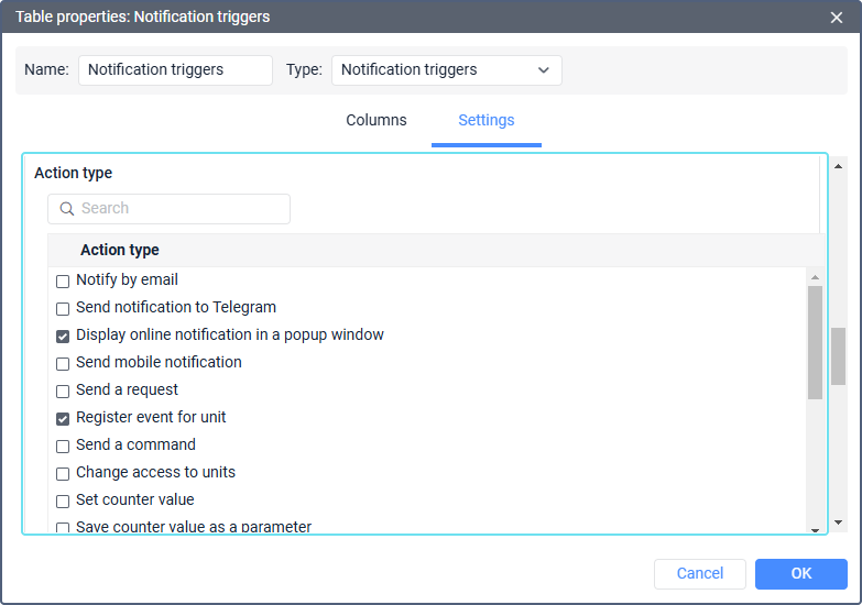

Action type
The filter is available for the Notification triggers table.
If you want to include the triggered notifications only with certain actions in the table, mark the actions in the list. To find the necessary notification action, use the search field above the list.
See also the Notification name, Notification type and Notification text filters.

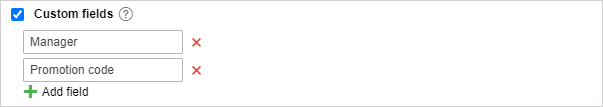

Custom fields
The filter is available in the Orders table and works by custom fields specified in the order properties in the Logistics application. It allows you to specify the names of custom fields which should be shown in the report. If the filter is disabled, the report shows all the custom fields from the orders included in the routes for the selected report interval.

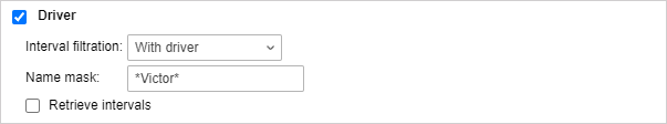

Driver
This filter allows you to include the intervals within which drivers were assigned to the units, or to exclude such intervals from the report.
The following options are available in the filter:
OptionDescription
With driver
The report shows those intervals within which drivers were assigned to the units.
In the Name mask field, you can specify the name mask of the driver whose intervals should be included in the report. The mask also works if several drivers were assigned to the unit simultaneously within a certain interval. To see several drivers in the report, enable the Multiple drivers/trailers option in the template settings.

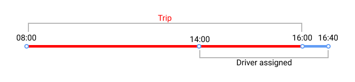

Example. A report on trips is executed. During one of the trips, two drivers were assigned to the unit: John and David. If John is specified in the Name mask field, the report shows only those trips, during which only this driver was assigned. If *John* is specified in the field, the report also shows the trip during which the two drivers were assigned.
The intervals are shown entirely, regardless of when the driver was assigned: at the beginning, end or middle of the interval. If you want to see exactly the part of the interval during which the driver was assigned to the unit, enable the Retrieve intervals option.
Without driverThe report shows the intervals during which no driver was assigned to the unit.

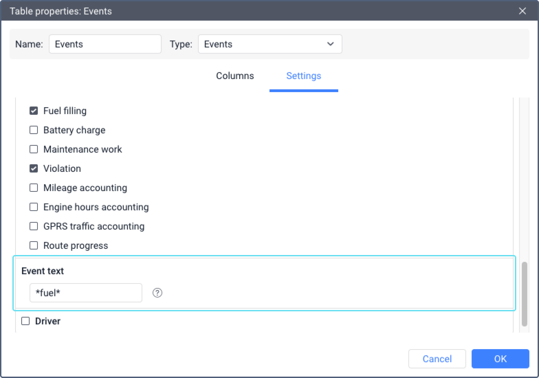

Event text
This filter is available for the Events and Violations tables.
If you want to include in the table only those events whose text contains certain words or values, specify their mask.
See also the Event and Event type filters.

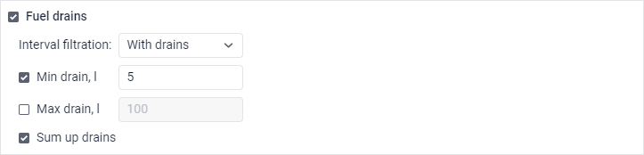

Fuel drains
The filter allows you to see the intervals within which fuel drains were detected or intervals with no fuel drains.
If the With drains option is selected, then you can specify the minimum and/or maximum amount of fuel drained at one time in the Min drain and Max drain fields in order for the interval to be included in the report. If the Sum up drains option is activated, then the sum of all drains within the interval should meet the conditions from the fields.
Example. A report on trips is executed. A value of 5 l is specified in the Min drain field. During the trip, drains of 2 l, 3 l and 4 l were detected. If the Sum up drains option is disabled, the trip is not shown in the report. If it is enabled, the trip is shown because the total volume of drains is 9 liters.

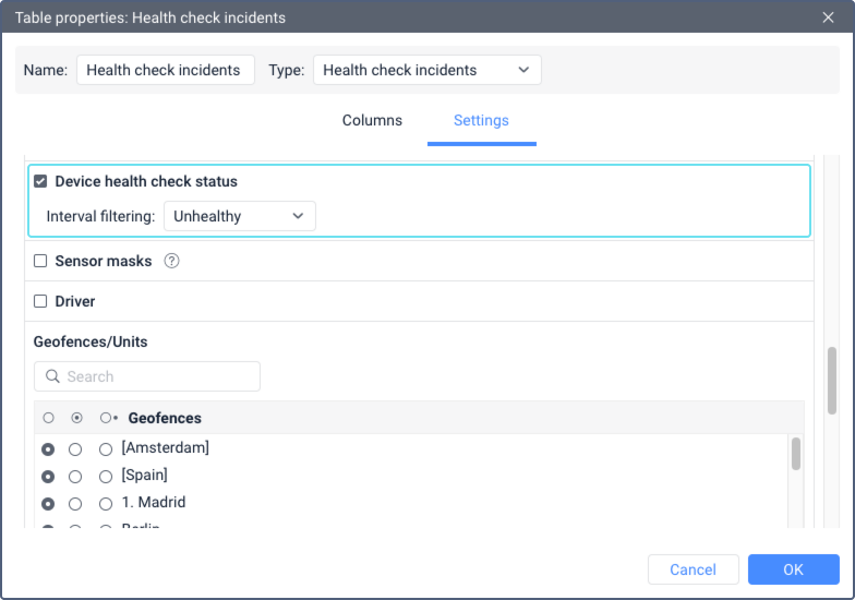

Device health check status
This filter is available for the Health check incidents table.
It allows filtering the incident intervals depending on the unit device status at the beginning of the incident interval. For details about device statuses, see the Dashboard page.
Option Description
All The table shows all incident intervals.
Need attention The table shows only those incident intervals at the beginning of which the unit device status was Need attention.
Unhealthy The table shows only those incident intervals at the beginning of which the unit device status was Unhealthy.

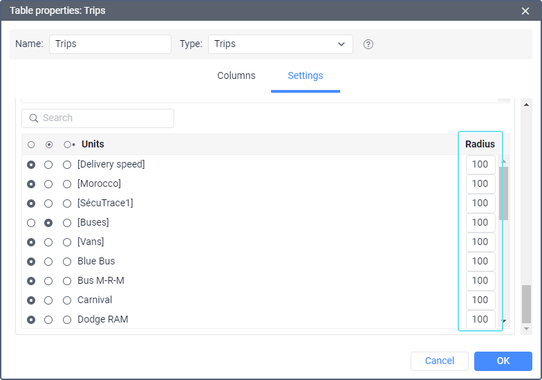

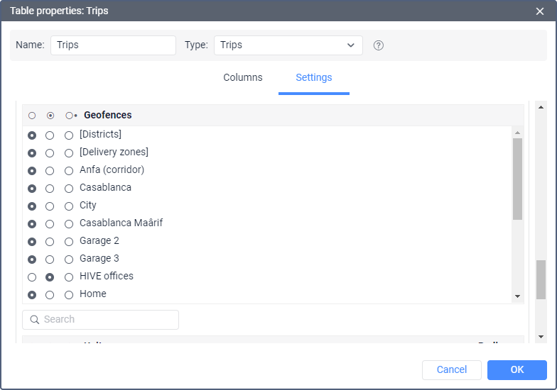

Geofences/Units
The filter allows you to see those intervals within which the unit was inside or outside of the selected geofence or area around the selected unit. Only geofences that belong to the same resource as the report template itself can be displayed here.
By default, the intervals are shown entirely. To see only those parts of the interval during which the unit was inside or outside of the geofence/unit area, enable the Retrieve intervals option.
The filter section consists of two lists: the list of geofences and the list of units. Above each list, there is a dynamic search by item name.
List of geofences
For each list item, you can specify one of three statuses:
  • : The item (geofence or unit area) is not taken into account.
  • : Intervals inside this geofence or unit area. The report table includes those intervals where the unit sent at least one message inside the selected geofence (or unit area). Example. In the image below, the Trips table is filtered by the Inside “Railroad” geofence criterion. It includes a trip during which the vehicle sent messages within this geofence, though only briefly.
  • : Intervals outside this geofence or unit area. The report table includes those intervals where the unit sent all messages outside the selected geofence (or unit area).

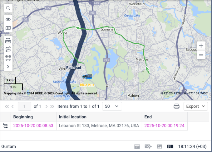

    Example. In the image below, the Trips table is filtered by the Outside the “Railroad” geofence criterion. It includes three trips which had no message inside this geofence.
For units, you can specify the radius of the area around them, that is, how close the unit on which the report is executed should be to these units in order for the interval to be included in the report.
List of units
To select all the items in the list, hold Ctrl while selecting them. If a group is marked, then all the geofences or units from the group are considered selected. In this case, an interval is shown in the report if any of these geofences and/or unit areas were visited during it.
In the properties of the Fuel traffic table, the Include only units with tank fuelling option is available in the Geofences/Units filter. It allows you to see only those units that were refilled within the report interval, when a unit from the report was inside their radius. For example, this option can be used in a situation where a fuel tanker refills several vehicles.

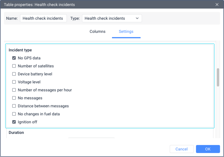

Incident type
The type of incident depends on the criteria set in the unit properties. For details, see the Health check page.
If you want to include only certain incident types in the table, mark them in the list.

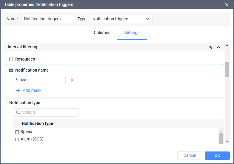

Notification name
Here you can specify masks for the names of triggered notifications.
See also the Action type, Notification text and Notification type filters.

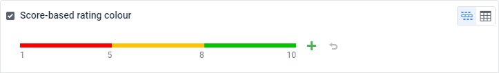

Score-based rating color
This filter is used in the Eco driving table for the report on a group of drivers. The filter allows highlighting rank cells with different colors.
You can specify rank values and their corresponding colors in the table or scale mode. Specifying the rank colors, with some exceptions, is similar to specifying the color intervals for the sensor.

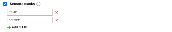

Sensor masks
Here you can specify the masks of the sensors which should be taken into account when executing the report. The specified masks influence:
  • Sensors filter;
  • values in the Counter, Initial counter, Final counter columns;
  • values in the columns related to engine revolutions, temperature and fuel;
  • custom sensor values if the Custom sensor masks filter is not used.
The mask of the engine hours sensor is specified separately in the Engine hours sensor filter.

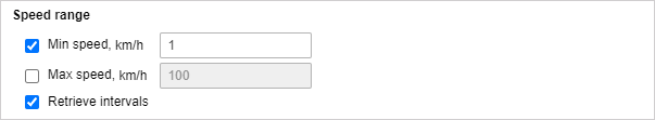

Speed range
Here in the Min speed and Max speed fields, you can the minimum and/or maximum unit speed required for the interval to be included in the report.
If you want the report to show only those periods during which the speed met the specified conditions, activate the Retrieve intervals option.

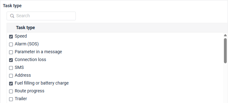

Task type
This filter is available for the Tasks table.
If you want to include only certain task types in the table, select them in the list. To find the necessary type, use the search field above the list.
See also the Task name and Task type filters.

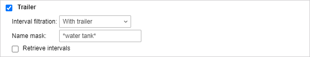

Trailer
The filter allows you to see the intervals within which a trailer or no trailers were assigned to the unit. The options in this filter work in the same way as the options in the Driver filter.

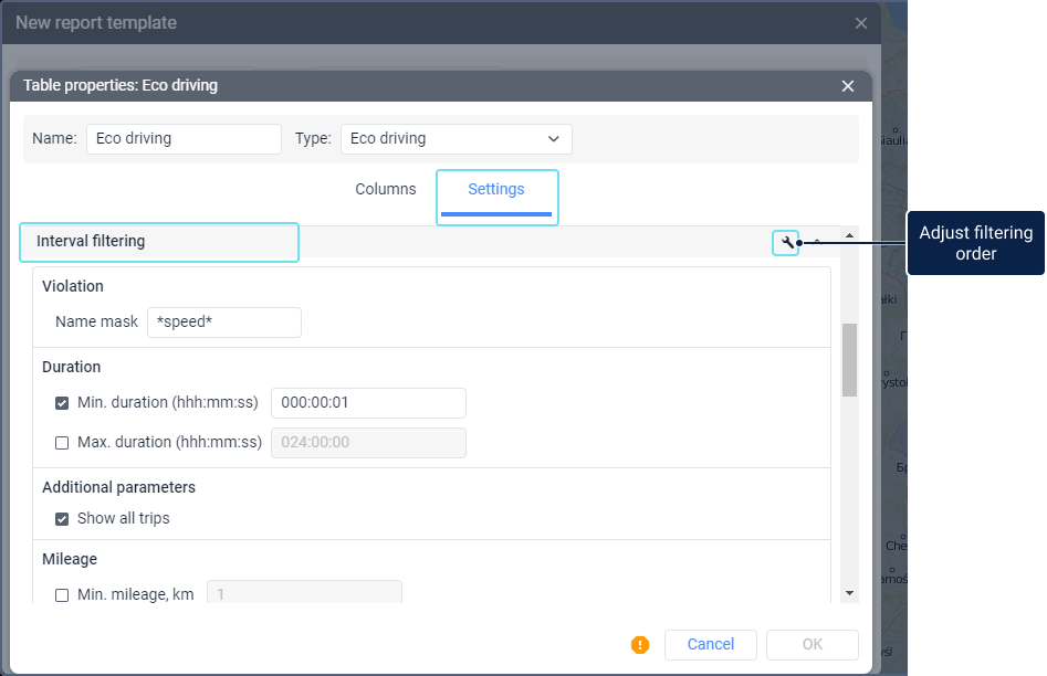

The filter is available in the Eco driving table. Here you can specify the name mask of violations which should be taken into account when executing the report.
‘Retrieve intervals’ option

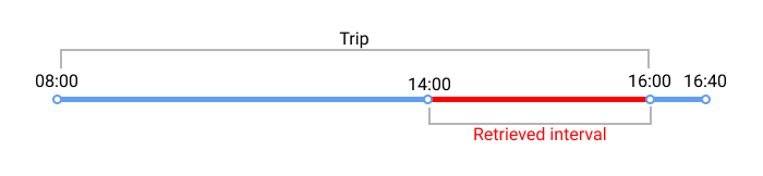

The Retrieve intervals option is available for some filters. It allows to show in the report table only those segments that match the additional criteria specified in the interval filter.
Example 1. The With driver filter is used in a trip report. The trip lasted from 08:00 to 16:00. The driver was assigned to the unit at 14:00 and separated from it at 16:40. If the Retrieve intervals option is disabled, the report shows the entire trip from 08:00 to 16:00.
If the option is enabled, only the part of the trip from 14:00 to 16:00 is shown.

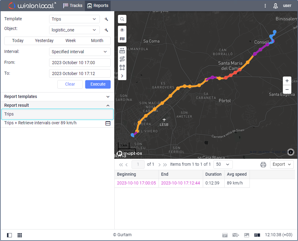

Example 2. A report on trips is being executed. It is known that the unit travelled at speeds above 90 km/h during the indicated period of time. On the unit track the speed above 90 km/h is marked in orange color, and above 120 km/h is marked in red color. The user needs to show in the report only the segments where the unit travelled at a speed of 89 km/h and above (Image 1).
Image 1
To do this, in the Speed filter, specify a minimum value of 89 km/h. If you execute the report with these settings, it will show the entire interval where the speed was higher than 89 km/h (Image 2).
Image 2
To show in the report only those segments where the speed was higher than 89 km/h, you need to enable the Retrieve intervals option in the Speed filter.
This will exclude the segments marked on the track with purple and blue color (Image 3).
Image 3
