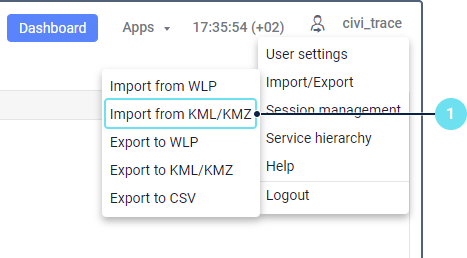

  1. In the user menu, select the Import/Export item and click Import from KML/KMZ.
