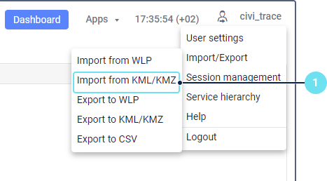

  1. In the user menu, select the Import/Export item and click Import from KML/KMZ.

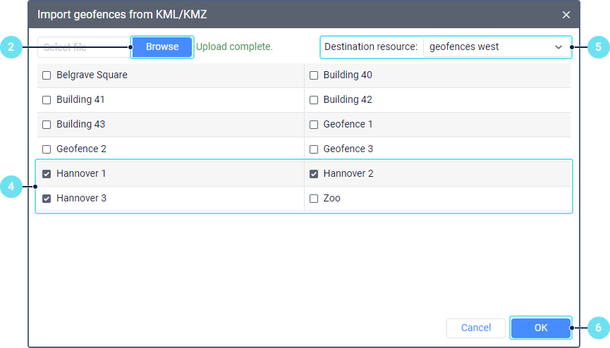

  2. Click on the Browse button and select the required KML or KMZ file.
  3. Click Upload. The selected file will be processed, and its contents will be displayed in the window.
  4. Select the geofences which should be imported.
  5. Select the resource to which you want to copy the geofences. If the resource already contains the same-name geofences, then as a result of the import, it will contain several geofences with the same name.
  6. Click OK to complete the import.
