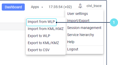

- In the user menu, select Import/Export item and then click Import from WLP.

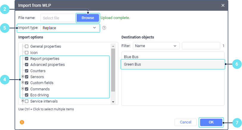

- Click on the Browse button and select the required WLP file.
- Click Upload. The selected file will be processed, and its contents will be displayed in the Import options section.
- In this section, select the data which should be imported.
The list of the data which should be imported is checked for incompatible units of measurement, because it is not possible to transfer data from an object or a file which uses one system of measurement to an object which uses another.
- Select the import type: Replace, Merge, or Append.
- In the Destination objects section, select the objects to which the data should be imported. To find the required objects quickly, use the dynamic search and various search criteria.
- Click OK.
