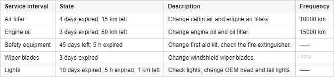

The upcoming maintenance table contains the list of service works set for a unit and the status of their execution. The table can include the columns described below.
Column | Description |
Service interval | The name of the scheduled maintenance work indicated on the Service intervals tab of the unit properties dialog in the Service name field. The work should be repeated throughout a particular interval indicated on the Service intervals tab. |
State | The overall state of the execution of the service work. In other words, it is the remaining or expired interval of mileage, engine hours, and days. |
State by mileage | The remaining or expired mileage interval. |
State by engine hours | The interval of the remaining or expired engine hours. |
State by days | The interval of the remaining or expired days. |
Description | The information taken from the corresponding field on the Service intervals tab. |
Frequency | The interval (mileage, engine hours, or days) that shows how often vehicle maintenance should be performed. |
Notes | An empty column for your custom comments. |
