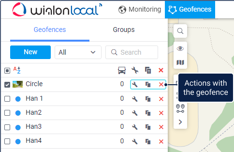

List of geofences
By default, geofences are listed in alphabetical order. To switch between the forward and reverse alphabetical order, use the icon  /
/ . To quickly find the required geofence, use the dynamic filter or the filter by property (polygons, lines, circles) or by resource.
The list of geofences contains icons that show information about geofences and allow you to perform actions with them.
| Icon | Description |
| // | The types of geofences: polygon, line, circle. These icons are shown next to the names of the geofences for which no image is selected. |
| The number of units within the geofence. The list of these units is available in the geofence tooltip. If the Presence in geofences option is not enabled in the user settings, question marks are displayed in this column. | |
| / | Open the geofence properties. If you have the Create, edit, and delete geofences access right, you can change the geofence size, type, location on the map, and other properties, except for the resource. If there are more than 5000 points in a geofence, you can’t edit it. |
| Copy the geofence, that is, create a new geofence using the selected one as a template. | |
| / | Delete the geofence. The icon is inactive if you don’t have the Create, edit or delete geofences access right. To delete several geofences at once, select them and click on the iconabove their list. |
