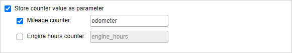

Save counter value as a parameter
This action allows you to save the value of current mileage (odometer parameter) or engine hours (engine_hours parameter) as a parameter in the message. This is required in order to show the initial and final mileage values in the report on trips and convert the engine_hours parameter into the engine hours sensor for further operations. To do this, you should have the Edit counters access right to the unit.
For more precise calculations, it is advisable to store counter values while the unit is parked, for example, once a day at night time.
