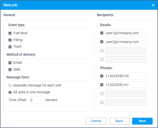

When you create the job, the following settings are available:
SettingDescription
Event type
Select the type of events about which you want to receive information: fuel level, filling, or theft. You can select more than one.
Fuel fillings and thefts are detected in accordance with the settings of fuel sensors.
The information about fillings and thefts is sent only if they are detected.
The data on the fuel level is sent under any circumstances. For this event type, the system takes into account only the readings of fuel level sensors and ignores fuel consumption sensors (AbsFCS, InsFCS, ImpFCS). If there is no fuel level data, a message with the text
Fuel level is unknown is sent to the recipients.
Method of delivery
Select the method of receiving information: SMS and/or email. In the Recipients section on the right, specify the phone number and email address of the recipient, respectively. The phone number should be indicated in the international format.
To send SMS messages, the Can send SMS option should be enabled in the user properties.
To send emails, you should specify the email address from which system messages should be sent in the billing plan properties.
Message formIf several units are selected for the job, you can specify in this section whether fuel information should be sent in a separate message for each unit or in one common message.
Time offsetIn this field, you can specify by how many minutes the interval should be extended to analyze messages for detecting fuel fillings and thefts. The start time of the interval is shifted to an earlier time by the specified number of minutes (see Job execution intervals for details). This option allows taking messages from the black box into account.
