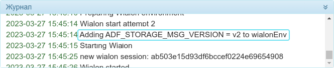

  3. Install the update. The entry Adding ADF_STORAGE_MSG_VERSION = v2 to wialonEnv will be displayed in the log in the administration system of the primary server:

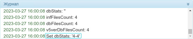

You can monitor the process of converting the primary server database in the log of the administration system. There will be a record like Set dbStats: ‘X-Y’ every 10 minutes. If X is equal to Y, then the conversion process is complete:

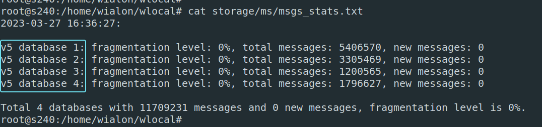

You can also check if the conversion has ended in the /home/wialon/wlocal/storage/ms/msgs_stats.txt file. All database files must be V5:

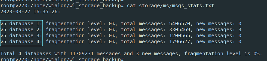

Make sure the databases on all backup servers are also converted. To do this, check the contents of the storage/ms/msgs_stats.txt file on the backup servers. All database files must be V5:
