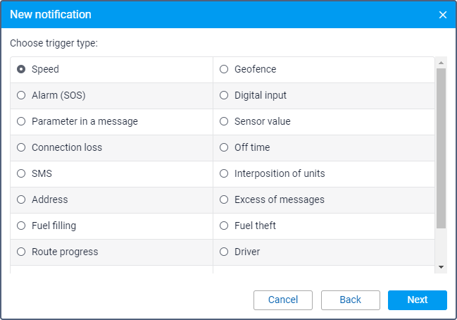

Notification Types
Depending on the conditions of triggering, notifications in Wialon are divided into types which you can select when creating the notification.
The measurement system applied to the settings of each notification is the same as the measurement system of the resource to which the notification belongs.
Below are all the possible notification types and the parameters available for them.

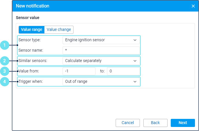

Sensor value
For a notification of this type, two control methods are available:
  • Value range. Allows specifying a range of sensor values to control whether the received values fall in it or not.
  • Value change. Allows specifying one value to control whether the received values exceed it or not.
This notification can’t control the values of the sensors which use parameters from previous messages. In this case, the notification won’t be triggered.
For the Value range method, follow these steps:
  1. In the drop-down list, select the sensor type and/or in the Sensor name field, specify the name mask using special characters (* and ?).
  2. In the Similar sensors drop-down list, select one of the available options:
    • Sum up values. The values of all sensors of the selected type and/or sensors with the same name mask are summed up. Thus, the sum of all values is taken into account before the notification is activated.
    • Calculate separately. The values of all sensors of the selected type and/or sensors with the same specified name mask are controlled separately.
  3. Specify the minimum and maximum values of the sensor.
  4. Select the activation type:
    • In range. The notification is activated when receiving values which fall in the specified range, including the values specified as minimum and maximum ones.
    • Out of range. The notification is activated when receiving values which don’t fall in the specified range.
For the Value change method, open the same-name tab on the right and follow steps 1 and 2 from the instruction above. In the Delta field, specify a difference when exceeding which the notification should be triggered. The sensor values can be increased or decreased because the specified delta is compared with the module (for example, |12 − 10| = 2 and |10 − 12| = 2).
