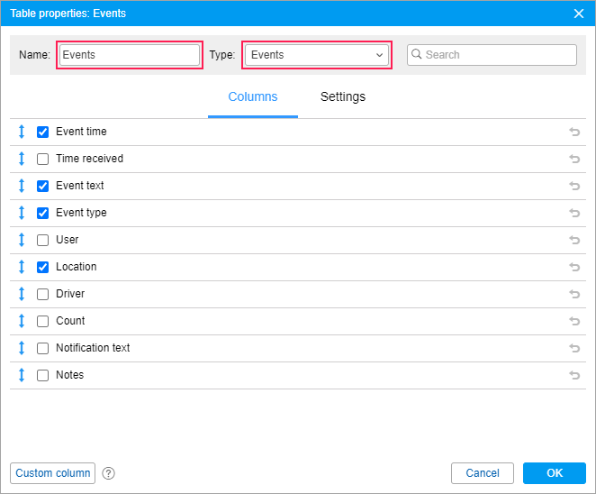

You can add any number of tables to a report template, including tables of the same type. To add a new table, open the Contents tab in the properties of the required report template and click on the New table button.
In the table properties, specify its name and type and select the columns you want to include in it. If necessary, add custom columns and configure additional settings.
Selecting columns
The set of available columns depends on the selected table type. To add a column to the table, check the box to the left of its name. To add all columns at once, hold down Ctrl and mark any column which is not selected. You can cancel the selection of all columns in the same way. To quickly search for columns, use the dynamic filter in the upper-right corner.
To edit the name of a column, click on it with the left mouse button. To use the default name of the column, click on the icon in its line. The icon is inactive is the default name is used.

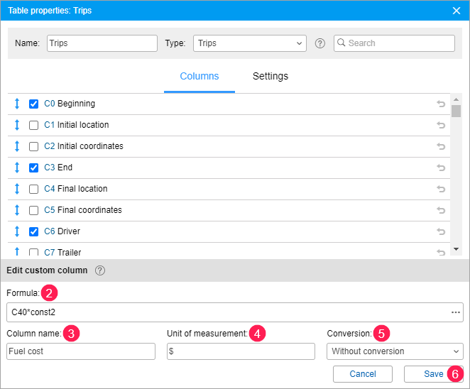

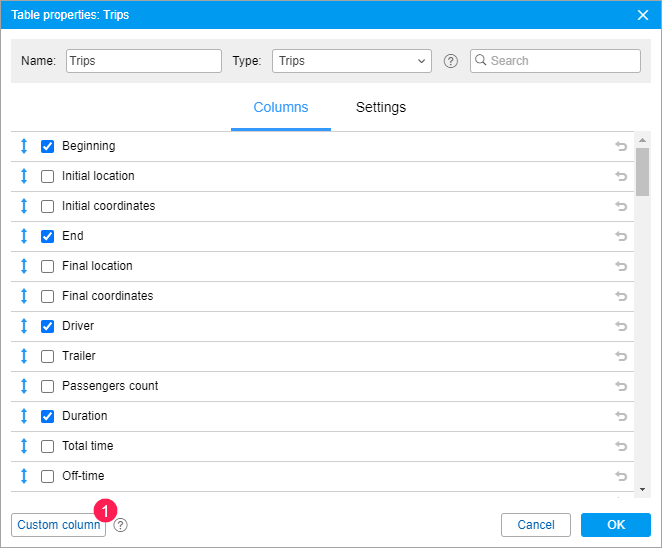

To add a custom column to the table, follow the steps below.
1. Click on the Custom column button.
2. Specify the formula for calculating the column value.
You can use the following components in the formula:

Formula example: (С1+С2+С7)*const1.5/rcoef
3. Specify the name of the custom column.
4. Indicate the unit of measurement (up to 10 characters).
5. If you use the custom column to calculate duration, select how it should be displayed in the Conversion drop-down list.
ItemDescription
Without conversionDuration is displayed in seconds.
Duration format
The Duration format option from the table settings is used. If there is no such option, the result is displayed in the hours:minutes:seconds format.
Date and time format
The date and time format indicated in the user settings is used.
If the value cannot be converted to the selected format, a dash is displayed in the custom column.
6. Click Save.
The custom column automatically goes to the top of the list. However, you can change its position in the standard way if necessary. Such columns are highlighted in blue and do not have an index.

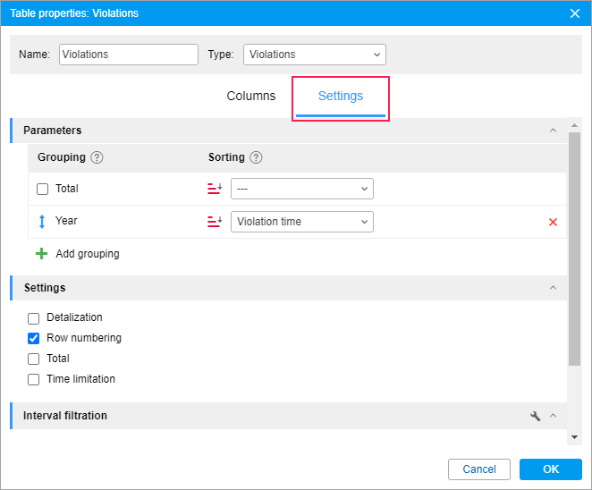

Table settings
For each table, in addition to selecting columns, there are additional settings, located in the same-name tab.
The tab is divided into three sections:
