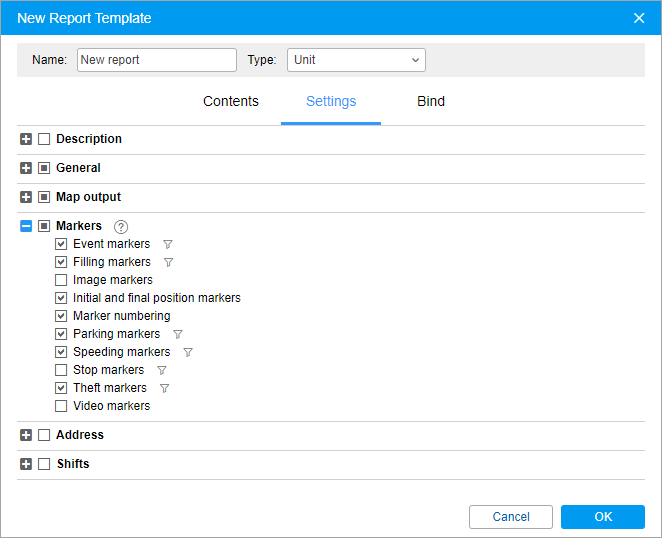

Markers
In this section, you can select the markers that should be displayed on the map, enable their numbering, and configure filtration for the markers shown on the map and in charts.
The table below shows all the available markers.

You can configure filtration (icon
) for filling, theft, stop, parking, speeding, and event markers. The filtration parameters configured in this section are applied to the markers on the map and in charts.
If necessary, you can enable marker numbering.

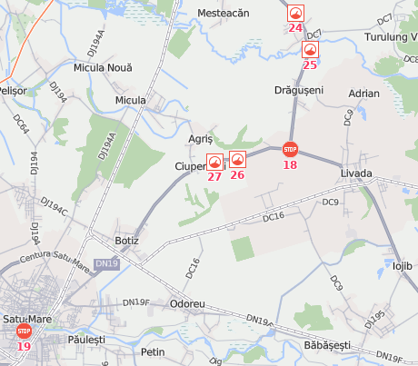

Markers on the map
The selected markers are displayed on the map after executing the report. To see all the available markers, zoom in.

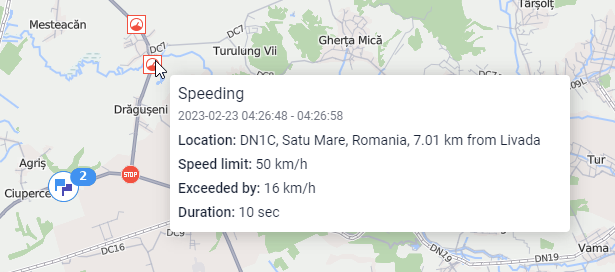

Tooltip
When you point to a marker, its tooltip displays additional information about what happened:

| Speeding | Start time (the time of receiving the first message with a speed value exceeding the allowed one) and end time, duration, location, speed limitation as specified in the unit properties, the value by which the speed was exceeded. |

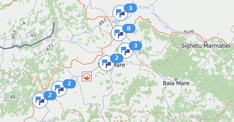

Marker grouping
Markers, as well as geofences, can be grouped in case they overlap each other. To enable grouping, activate the Group icons option in the report template. If there are 1000 or more markers, their grouping is enabled automatically. The group icon shows the number of grouped elements. In the icon tooltip, you can see detailed information about the events.
If more than 100 markers are grouped, the tooltip contains only their names without detailed information.

You can enable the Marker numbering option in a report template. In this case, each marker has its sequence number which is indicated below the marker in red color. Numbers are assigned chronologically, and each marker type has its own enumeration.

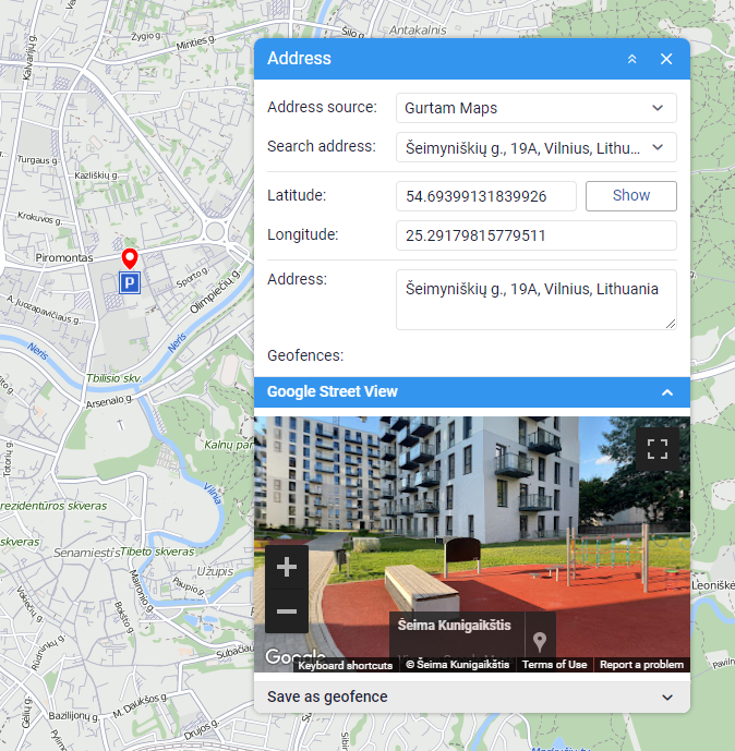

Panoramic images
The panoramic images of the territory can be displayed when clicking on the markers of parkings and stops. For this, maps with panoramas (for instance, Yandex Panorama or Google Street View) should be selected in the user settings. If there are pictures of the territory with the coordinates of the marker, when pointed at it, the cursor changes from arrow to hand. Click on the marker to open a panorama snapshot in the window of the Address tool. Double-click on another such marker to update the information.
