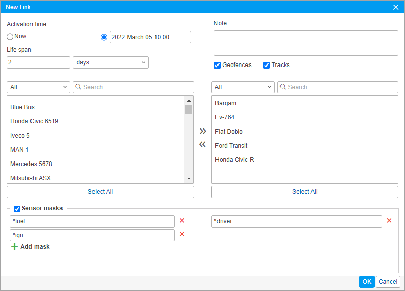

Creating links
Links are generated and edited in the locator dialog, which is accessible through the user menu.
To create a new link, click on the New link for sharing units button and fill in the fields of the form.
Indicate the activation time for the link in the upper left corner of the dialog. It can be Now or any other moment in the future (indicate the date and time in the calendar). Note that the activation time cannot exceed 100 days.
Furthermore, enter the lifespan of the link into the corresponding field. The value can be indicated in minutes, hours, or days (select from the dropdown list). Note that you can specify any value (from 0 to 1000) or make it unlimited (enter 0).
You can enter a note for your link in the upper right corner of the window. This allows distinguishing the link in the general list. Besides, the note (if entered) is shown in the header of the page of the locator itself.
You can also check the Geofences box here to share them in the link. Moreover, you can provide the possibility of generating and viewing the track of a unit by activating the Tracks checkbox.
The user that provides the possibility to view the track of a unit must have the Request reports and messages right.
Below, you select the units whose location you want to share. The selection is made in the list on the left. Transfer the required units to the list on the right (use double clicks or the Add button).
For the convenience of choosing units or unit groups, the contents of the list can be changed using the filter above it. The following variants are available: All, Units, Unit groups, Units outside groups. To find the required unit quickly, you can also use the dynamic filter.
Sensors with their values and units of measurement can also be shown in the locator. To do this, it is necessary to enable the corresponding option and indicate the masks of the sensors to be displayed.
To generate the link, click OK. To dismiss the changes, press Cancel.
