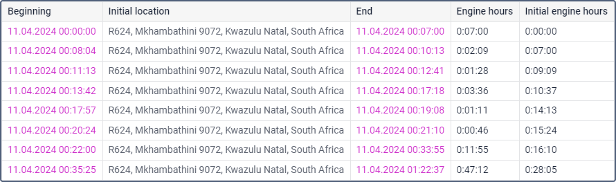

Engine hours
The Engine hours table shows how long the unit worked, how much time was in motion, how much fuel was spent for this period. Also, the duration and efficiency of the work of the attachable equipment can be shown.
To generate a report using the Engine hours table, the unit is supposed to have such sensors as ignition or absolute/relative engine hours sensor. The method of calculating engine hours is set in unit properties on the General tab. On the Advanced tab, you can also set Daily engine hours rate to calculate utilization and productivity.
In the Engine hours sensor section in the table settings, you can specify the mask for the main engine hours sensor that is used in the report. This allows you to separate the engines and create a table for each of them.
There are two options that can be used in the Engine hours table. They are timeout (set for a sensor) and maximum interval between messages (set for a unit). Both options are used to cut off invalid intervals when the amount of engine hours is defined. If values for both timeout and maximum interval between messages are indicated, the system will use the property with the minimum value indicated.
The Engine hours table can include the columns described below.
Column Description
Beginning The time when the engine hours interval begins.
Initial location The location of the unit when the engine or implement starts working.
End The time when the engine hours interval ends.
Final location The location of the unit when the engine or implement ends working.
Engine hours The value of engine hours at the interval. For an accurate calculation of engine hours, the device should send a valid value of the selected sensor. In case of receiving an invalid value, it is necessary to replace the sensor with a validator using the correct value.
Initial engine hours The value of the Absolute engine hours sensor at the start of the engine hours interval. If there are no values of this sensor within the interval for which the report is being executed, the initial value of the engine hours is calculated using the counter from the beginning of the interval to the first engine hour interval. In this case, the hour count starts from 0. If the sensor has sent a message with data not included in the scope of the engine hour interval, but included in the interval for which the entire report is being executed, the engine hour value is calculated by the counter with consideration of the absolute engine hour sensor data.
Final engine hours The value of the sensor Absolute engine hours at the end of the interval. Calculated based on the initial engine hours.
