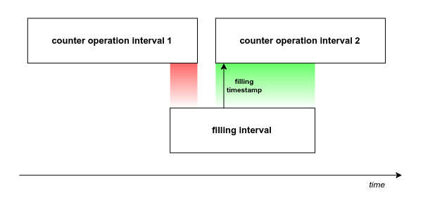

The Fuel traffic table determines the fuel activity of the unit (fuel filling, drain, counter operation), according to which the report is being executed, as well as the units that were near it. The following algorithm explains what principle the system uses to determine to which of the nearby units the fuel was distributed.
The intervals for the distribution and reception of fuel are considered to be adjacent if the time of the fuel filling of the unit that receives fuel has fallen into the interval of operation of the counter of the unit that distributed it (see the diagram).
If there was no such match, the algorithm searches for the intersection of the entire fuel filling interval of the unit that received the fuel with the intervals of the counter of the unit that distributed it and selects the nearest one (see the diagram).
