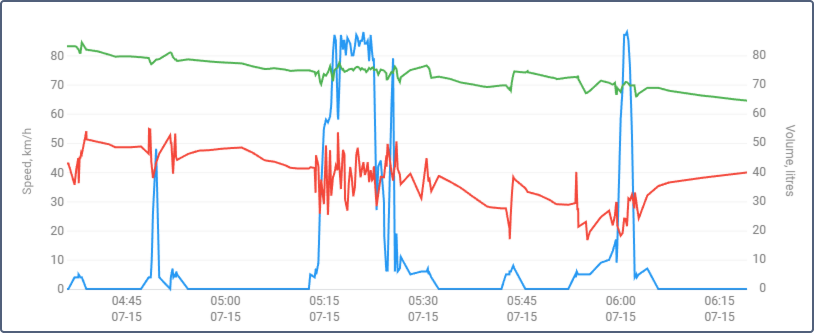

The picture below shows the speed chart combined with the fuel level chart. To receive such a chart, it is required to set the chart type as Regular and select the Speed, Speed (smoothed) and Fuel level data.
Each curve on a chart is assigned its own color. On the left, in the Report result block, you can specify which color corresponds to which curve. Their names are taken from the report template. In addition to the name for the curves, the units of measurement are also indicated.
The names of the lines of the chart can be changed in its properties in the report template. However, if the line is displayed on the basis of sensor readings, then it is given the name of the sensor. The sensors the readings of which should be displayed in the chart are selected in its settings.
Click on the curve name in the Report result section to enable/disable its display on the chart.

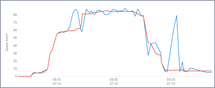

Smoothing
Most line charts of the Regular type have two versions: without smoothing and with smoothing. Smoothed versions are indicated in parentheses after the chart line name, for example, Speed (smoothed).
Smoothing affects the appearance of chart lines. Charts without smoothing are built strictly from message to message, resulting in angular outlines. Smoothed charts use a predefined smoothing algorithm to create smoother curves. This algorithm is the same for all charts and can’t be customized.
The smoothing algorithm applies a median filter with a window size calculated as the total number of points divided by 100.
Below is an example of a chart in which a blue line shows a speed chart without smoothing, and a red one shows a smoothed speed chart.

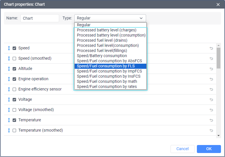

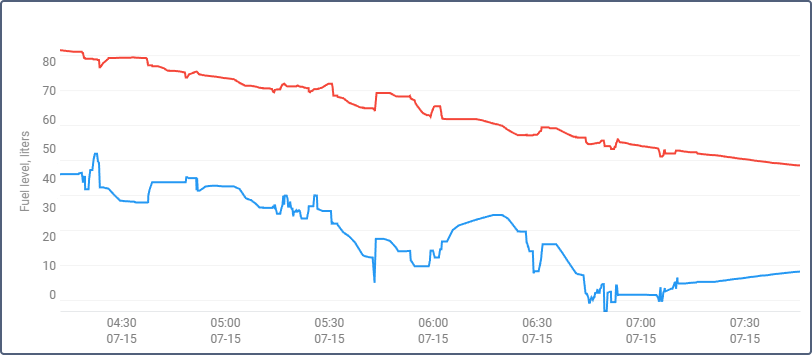

Regular fuel level charts
Two fuel level charts are available among the charts of the Regular type.
ChartDescription
Fuel level
Shows data taking the temperature coefficient into account without applying smoothing.
Processed fuel level
If filtering is configured in the properties of the selected sensor, smoothed data is shown. The smoothing depends on the filtering settings. The temperature coefficient is also taken into account in this chart.
Unlike special fuel level charts, the regular charts show data only in the litre-to-time ratio. However, you can select other data, such as voltage, so that it is displayed on the chart with the fuel level.

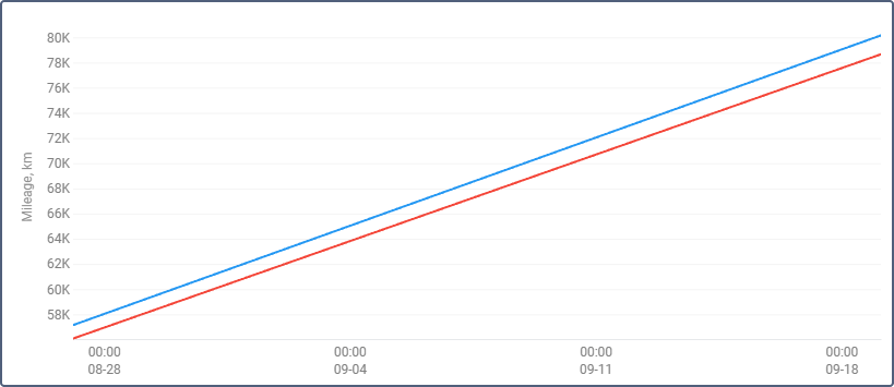

Regular mileage charts
Four kinds of mileage charts can be created: absolute mileage, mileage in trips, instant mileage, and instant mileage smoothed. The first two show how mileage changed (increased) over time. Absolute mileage chart is built on the basis of all messages, which means that any inaccuracy and outlying data affect the resulting chart. Mileage in trips chart displays the data taking trip detector settings into account. Below you see the chart with curves for absolute mileage (blue) and mileage in trips (red).
The Instant mileage chart represents the data in the mileage from the previous message to the current one form, that is the difference in the distance between two adjacent messages. This kind of chart can be useful to detect excessive mileage during connection loss, or to detect made-up additions to the mileage in cases where it is determined by special sensors (see the settings of the mileage counter in the unit properties). Instant mileage can be smoothed.

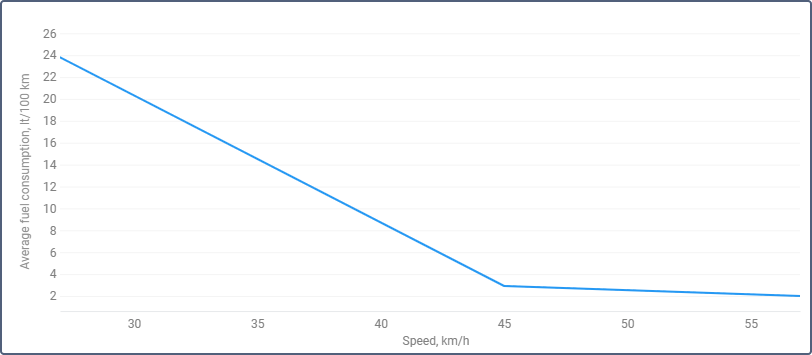

Speed/Fuel consumption chart
This chart shows the dependence of average fuel consumption on speed. The data for it is taken from fuel consumption sensors of different types (such as impulse, absolute, instant) or fuel level sensor, or predefined consumption by math or rates. The calculation methods must be specified in the properties of the required sensors.
