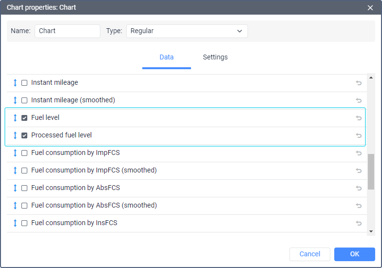

  1. Create a report template with a fuel level chart. To do this, add a chart of the Regular type to the report template and select the Fuel level and Processed fuel level items for this chart.

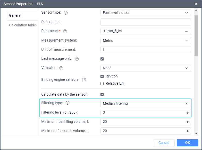

  3. Gradually increase the filtering level starting from 0, running the report again every time. To change the filtering level without switching to another tab, use the icon  next to the unit name to go to its properties.

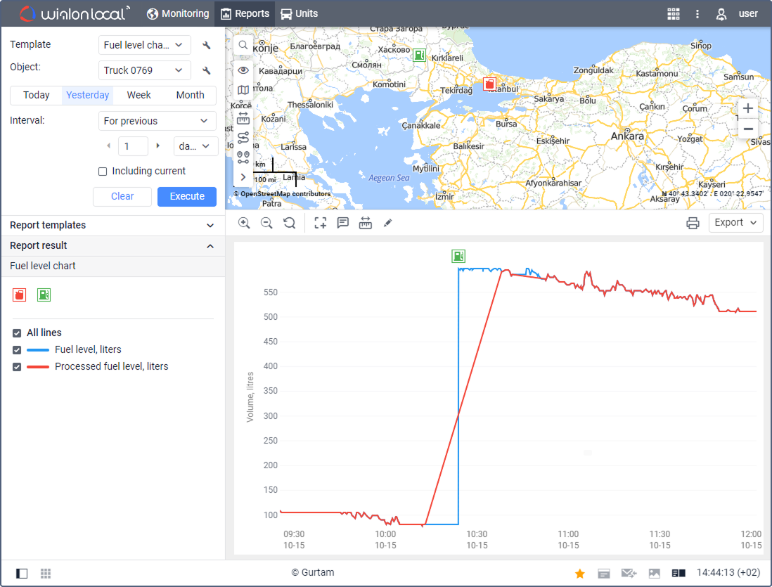

    Example of a chart when the filtering level is 0:

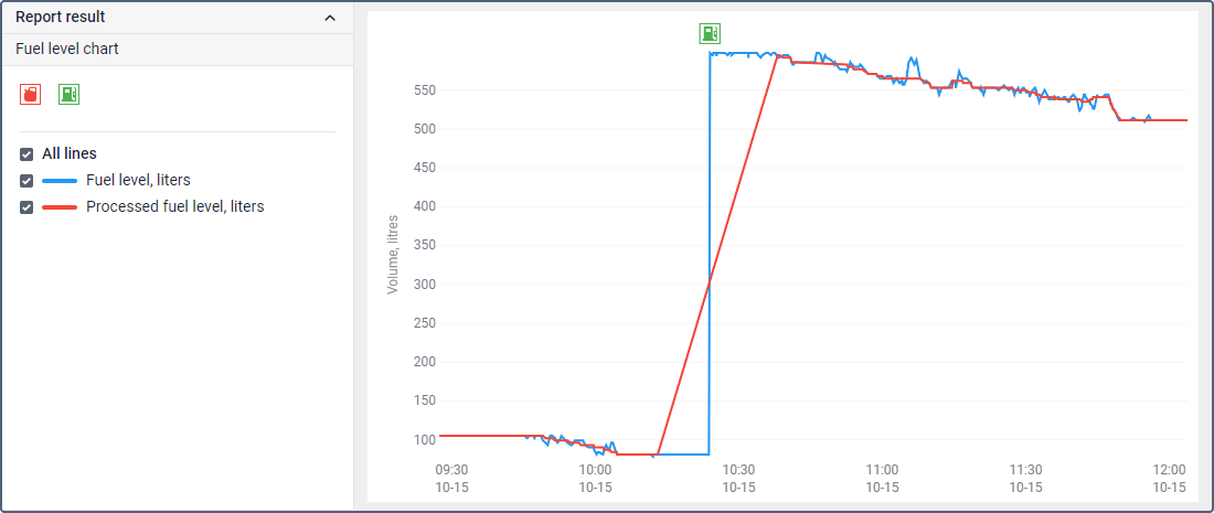

    Example of a chart when the filtering level is 5:

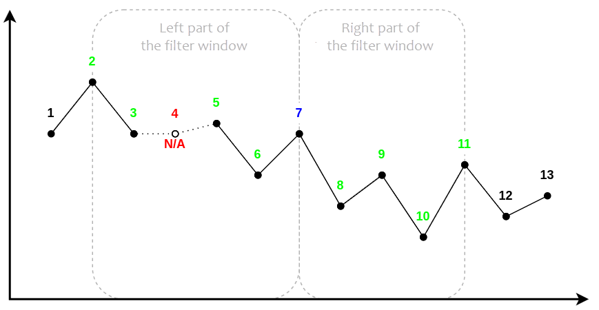

  2. The system places the filter window so that the message for which the smoothed value is calculated is in the center of the window. That is, there should be an equal number of messages before and after this message. Only messages with valid fuel level values are taken into account.
    For example, in the image below you can see how the filter window with a width of 9 messages is positioned. The message for which the smoothed fuel level value is calculated is highlighted in blue. It is the center of the window. Messages in green form the left and right parts of the window. Red indicates a message without fuel level data (not taken into account), while black represents messages that are not included in the filter window.

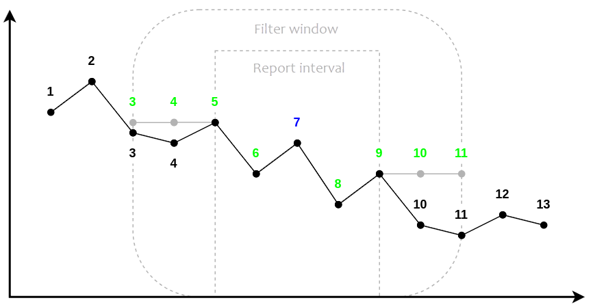

Example. In the image below, the smoothed value for message 7 is calculated.
The report interval includes messages 5 to 9, and the filter window is missing two messages both in the left and right parts. In this case, the filter window is completed as follows: the value from message 5 is used instead of messages 3 and 4, and the value from message 9 is used instead of messages 10 and 11.
Since the actual values from messages 3, 4, 10 and 11 are different from those used in the filter window (compare the gray and black lines), the final smoothed value for message 7 will be less accurate.
Thus, the smoothed result will be less accurate at the beginning and end of the interval if the FLS data changed immediately before and after the interval.
