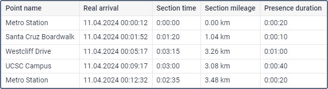

Check points
The Check points table displays information about the checkpoints that were set when creating the route and the visits to these checkpoints.
The Check points table can include the columns described below.
ColumnDescription
