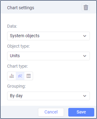

If you need to edit the graph, click on the button in the form of a gear located in the upper right corner of the header. Make the necessary adjustments in accordance with the data type and press Save.

This block contains information on the increase or decrease in the number of system objects in use (units, users, resources, routes, notifications, jobs, sensors, drivers, trailers, geofences, passengers). The Total indicator shows the total increase or decrease in the reporting period.
The data of the System objects graph can be presented in the form of a bar or a line chart, or a table and grouped by days/weeks/months/quarters.
Each graph contains information about added and deleted objects. If the object Units is selected, the number of activated and deactivated units is also shown.  In addition, the bar and line charts show the difference between the number of added and deleted objects from the beginning of the period to the selected point on the graph (Overall).
