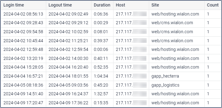

“Logins” table
The Logins table shows what services the user logged in and how often. The table can contain the columns described below.
ColumnDescription
Login timeThe time when the user logged on to one of the services.
Logout timeThe time when the user exited the service.
DurationThe time interval the user was online.
HostThe address of the computer from which the user logged in.
SiteThe name of the service to which the user logged in. If the user logged in using the web interface, the web/ prefix is added to the service name.
CountThe number of logins.
NotesThe empty column for custom notes.

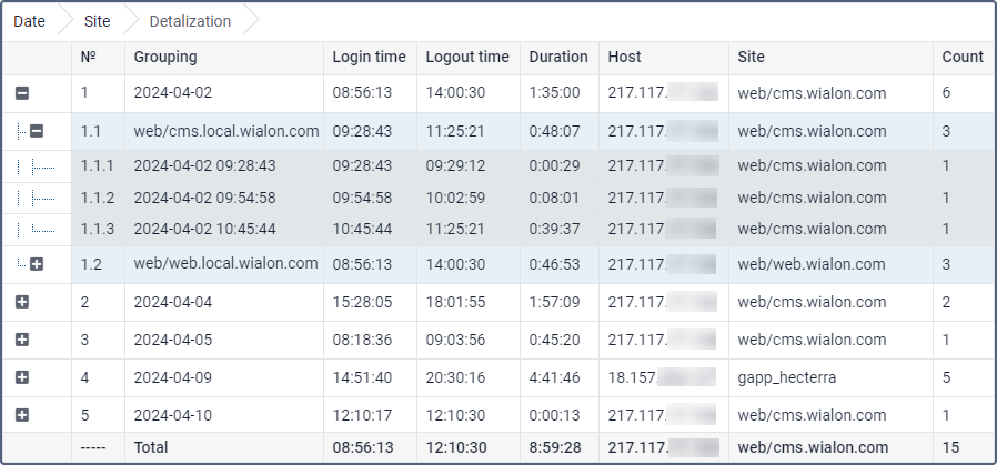

The same settings as for all the other tables can be applied to the user logins table: grouping, detalization, row numbering, total row, and time limitations. In the example below, you can see the user logins table with grouping by days, detalization, numbering, and total row.

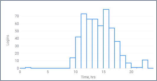

Two kinds of charts can be attached to the report on user logins: Logins/Hours and Logins/Days of the week. To get these charts, click on the Add chart button and select the type in the drop-down list of the report template.
The Logins/Hours chart shows the frequency of the user’s logons to the system at different times (hours):
