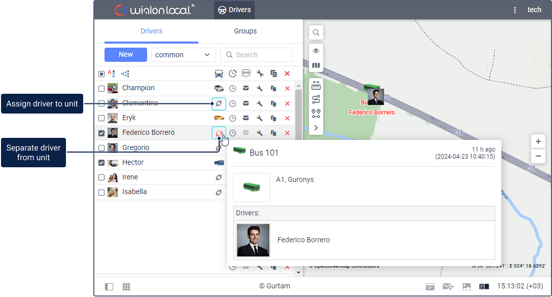

You can assign or separate a driver from a unit manually in the Drivers or Groups mode on the Drivers tab using the icons  and  respectively.

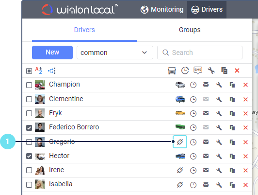

To assign a driver to a unit manually, follow these steps:
  1. Click on the icon opposite to the required driver in the list of drivers or their groups. If you don’t have the Create, edit and delete drivers access right to the resource, the icon is inactive ().
  2. In the open window, select the unit to which you want to assign the driver. Here you can see the units from the work list on the Monitoring tab. To see all units to which you have the View object and its basic properties access right, click on the icon  to the left of the search.
  3. Click OK.
After that, the icon of the selected unit is shown in the driver row.
To separate the driver from the unit, point to the unit icon in the driver row and click on the icon . You can also separate the drivers by registering new shifts for them or deleting their assignment (see more).

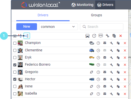

Automatic assignment list
To create an automatic assignment list, follow these steps:
  1. Click on the icon  above the list of drivers.
  2. Select the resource for the drivers of which you want to configure automatic assignment. To find out which drivers belong to a certain resource, apply filtering by resource to the driver list (displayed to the right of the Create button). If only one resource is available to you, it is selected automatically.
  3. Click Next.
  4. Select the units or unit groups to which the drivers of the selected resource should be assigned automatically. To switch between the lists of units and their groups, use the icon /. For more information about the unit selection, see Creating jobs.
  5. Click OK.
