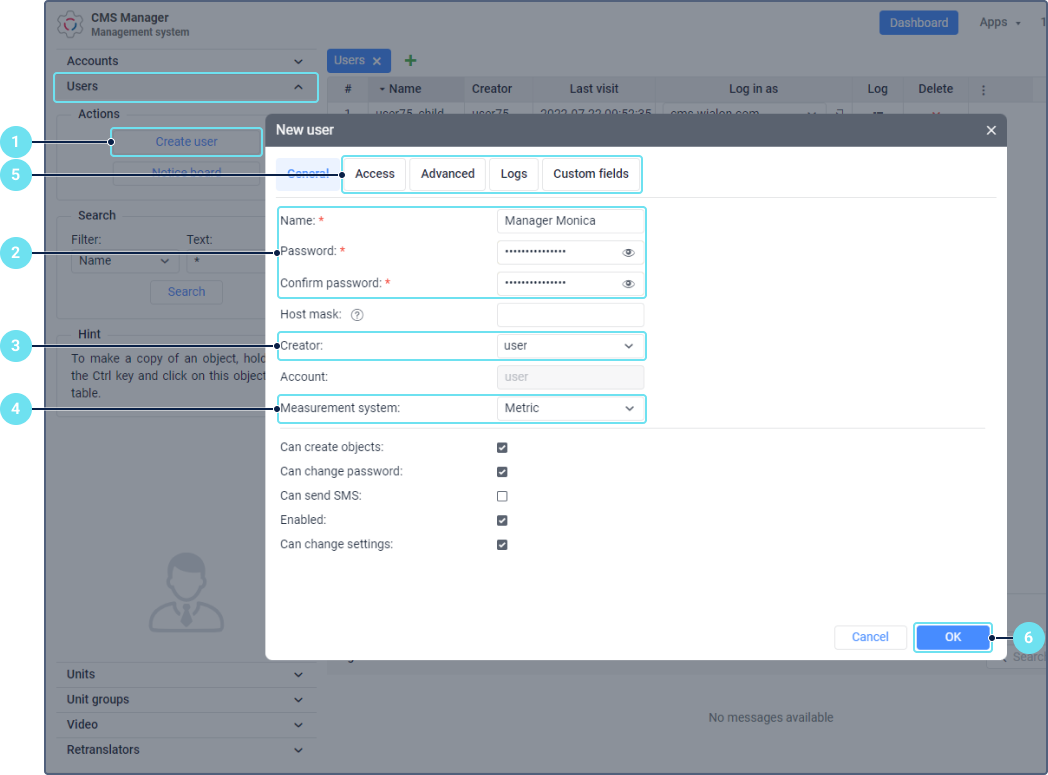

To create a user, follow the steps below.
  1. Click on the Create user button in the Users section.
  2. Fill in the required fields (Name, Password, Confirm password). These properties are described here.
  3. Select the creator of the user. After saving the user, you cannot edit this property.
  4. Select the measurement system for the user.
  5. If necessary, configure the Access, Advanced, and Custom fields tabs.
  6. Click OK.
To see the created user in the list, reload the page.
