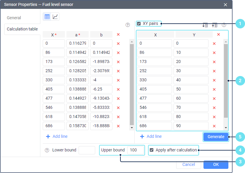

To configure the calculation table based on this data, follow the steps below.
- Activate the XY pairs tool on the Calculation table tab in the fuel level sensor properties.
- Add the required number of lines according to the values from the table obtained after the calibration of the fuel tank.
- Specify 100 in the Upper bound field.
- Activate the Apply after calculation option.
- Click Generate.

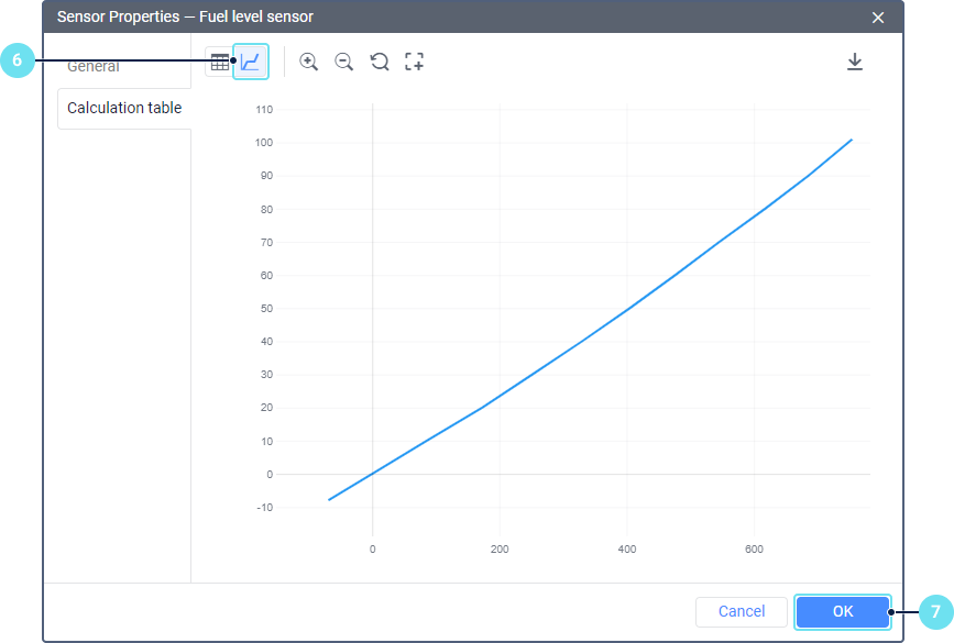

- If necessary, click on the icon
above the table to open the calculation chart.
- Click OK.
Note. You can see how the coefficient a and the displacement b were calculated. The first interval starts with 0 and influences all input values up to 86. At the last point, the output value should be 10. First, the displacement along the X-axis was calculated: ∆Х = 86 − 0 = 86. The displacement along the Y-axis was calculated in the same way: ∆Y = 10 − 0 = 10. Then, using the formula a = ∆Y / ∆X, the coefficient a was calculated, which is the tangent of the angle at the beginning of the coordinate axes: a = 10 / 86 = 0,11627906976744186.

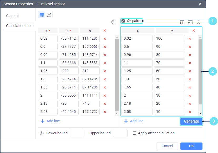

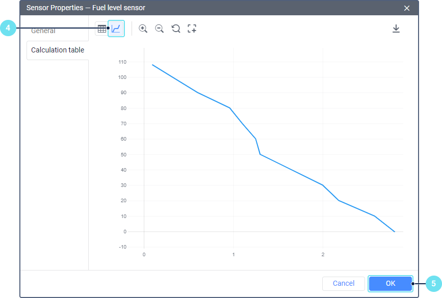

- Click Generate. After that, the indicated values Y are shown in descending order automatically.
- Click OK.
In this example, the table with formulas for calculating intervals looks as follows:

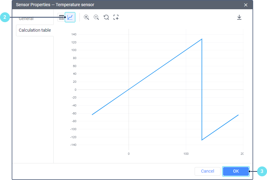

Before configuring the calculation table for the temperature sensor, find out what temperature the different values of the specified parameter correspond to. Consider the case when the parameter sends only positive values but some of them correspond to negative ones, that is, to the temperature below zero. For example:
- interval of positive values, from 0 to 127;
- interval of negative values, from 128 (which corresponds to −128 degrees) to 255 (which corresponds to −1 degree).
To configure the calculation table, follow these steps:
- On the Calculation tab of the temperature sensor properties, add two lines and specify the required values as follows:
- Click OK.

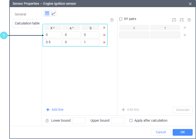

Consider an example of configuring the calculation table for a non-digital engine ignition sensor, when the ignition activation is determined by the parameter transmitting voltage. For example, at a voltage up to 0,5 V, the ignition is turned off, and at a voltage over 0,5 V, the ignition is turned on.
- On the Calculation tab of the engine ignition sensor properties, add two lines and specify the required values as follows:
