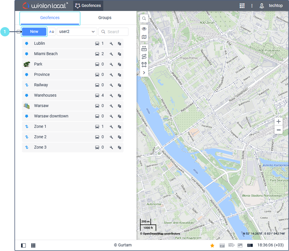

Steps to create geofences
To create a geofence, follow the steps below.

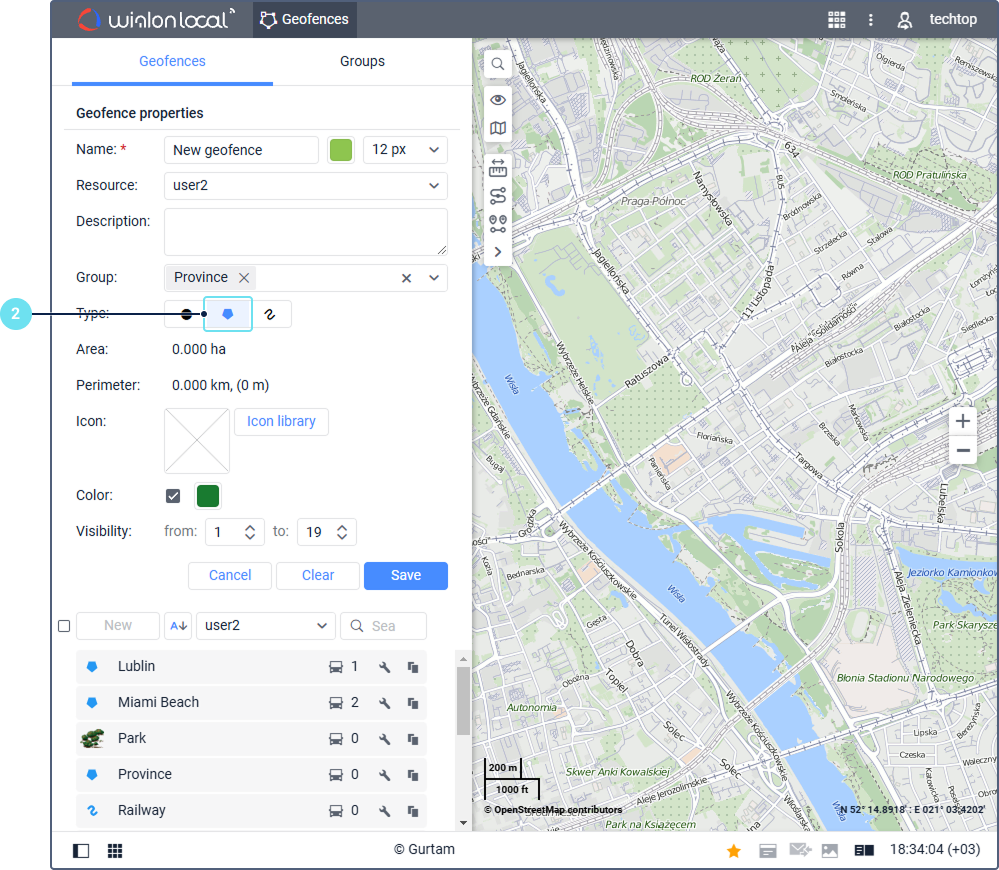

Click New on the Geofences tab.
Select the geofence type: polygon, line, or circle.

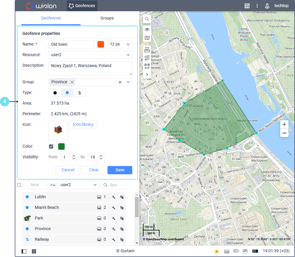

Specify the geofence properties.

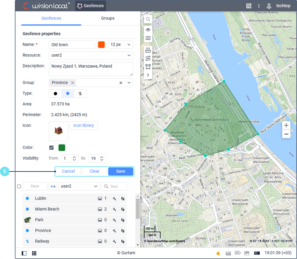

Click Save to save the geofence or Clear to start mapping the geofence again. To exit the geofence creation mode without saving the changes, click Cancel.

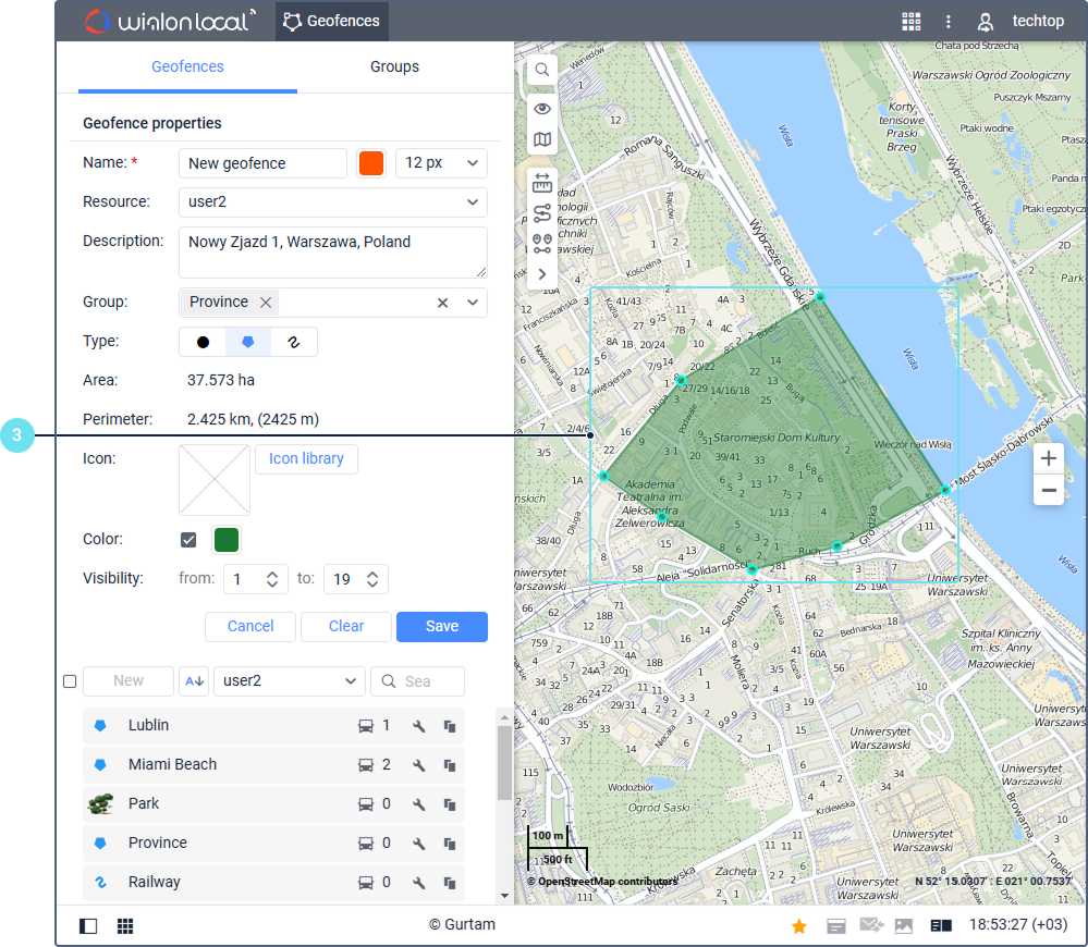

Polygon
To map a geofence in the shape of a polygon, follow these steps:
- Double-click on the map to put the first point.
- Put the second and the third point in the same way. After that, the third point is connected to the first to form a triangle.
- Put the subsequent points inside or outside of the triangle to shape the geofence.
You can also delete and move points as well as insert new ones between the others. These actions are described below.

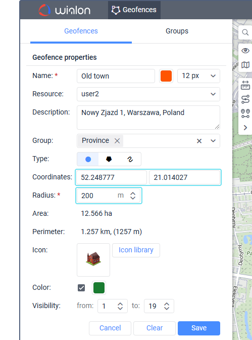

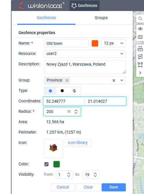

Circle
There are two methods of mapping a geofence in the shape of a circle:
- by putting the geofence centre point on the map;
- by specifying the geofence centre coordinates in the geofence properties;
Method 1
To map a geofence using the first method, follow these steps:
- Double-click on the map to put a point which should be the centre of the geofence.
- Specify the geofence radius in the Radius field. The default value is 100 m.
Method 2
To map a geofence using the second method, follow these steps:
- In the Coordinates field, specify the coordinates of the point which should be the centre of the geofence.
- In the Radius field, specify the geofence radius. The default value is 100 m.
