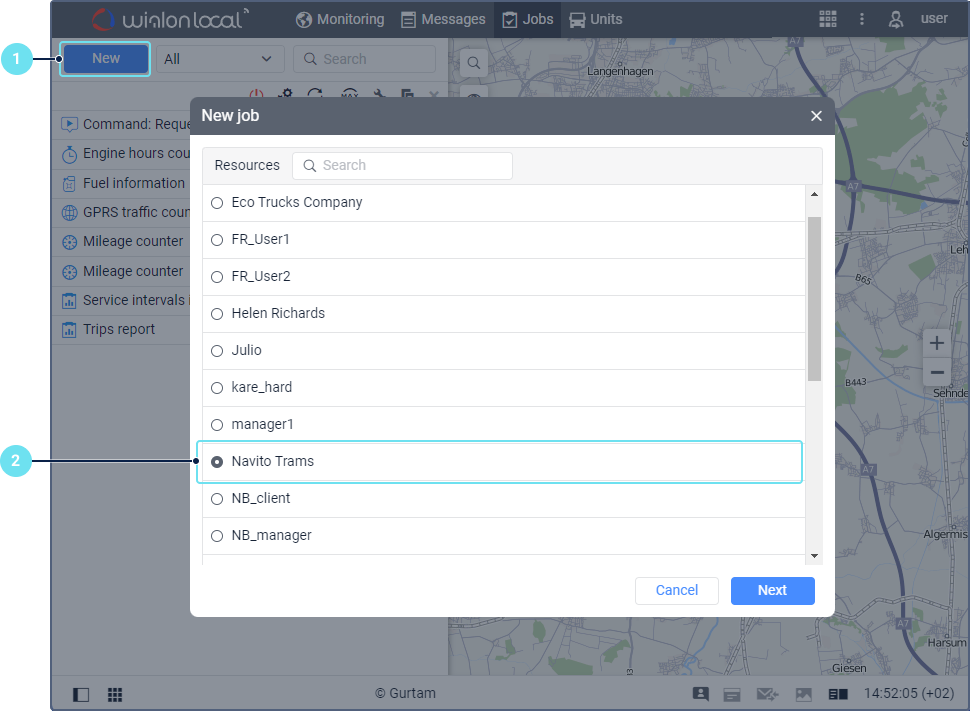

To create a new job, follow the steps below.
  1. Click New on the Jobs tab.
  2. Select the resource in which the job should be stored if you have more than one resource available.
