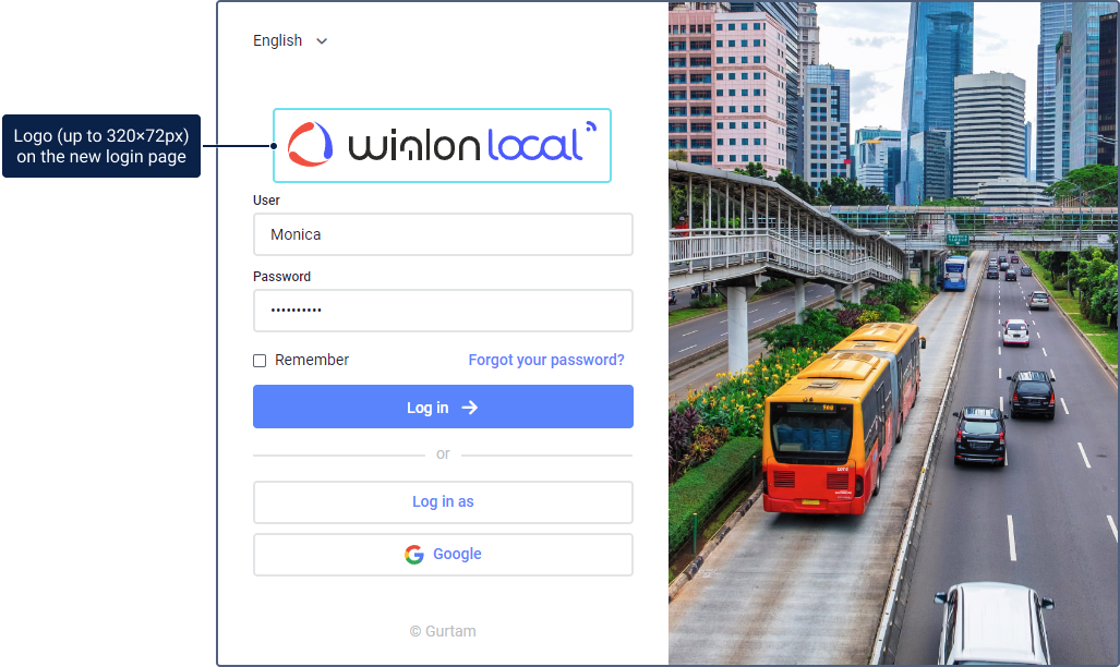

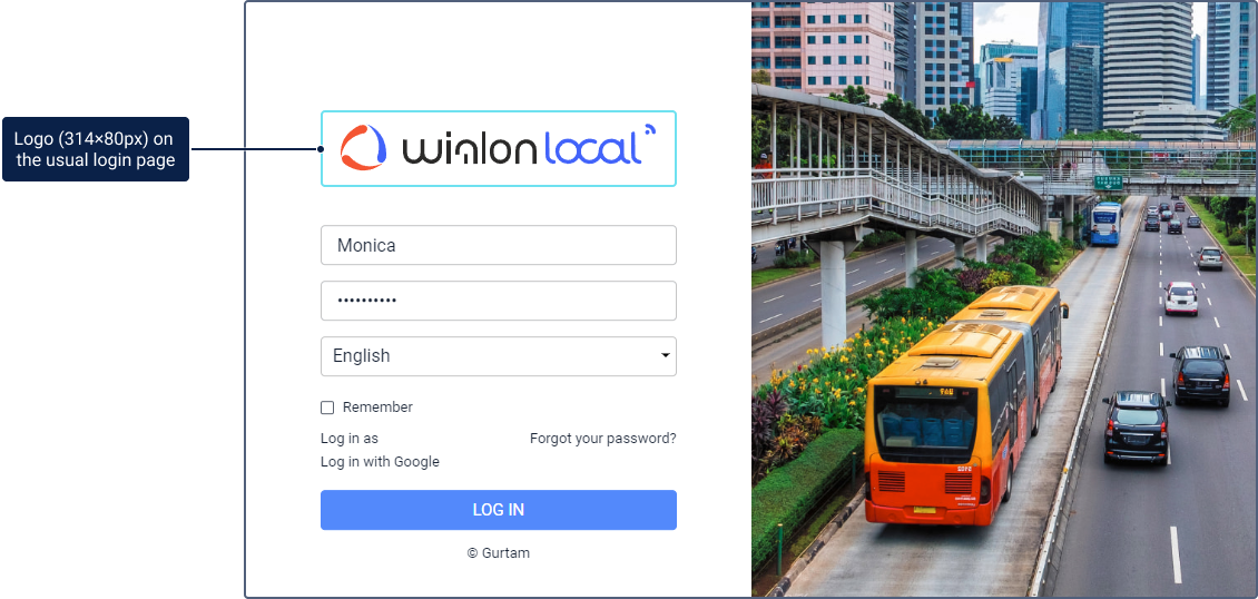

Login logo The logo that is displayed on the login page. You can use a PNG or SVG image. The size requirements depend on the New login page option in the general site settings. If the option is enabled and the new design of the login page is applied, the image size mustn’t exceed 320×72 pixels; if the option is disabled, the size mustn’t exceed 314×80 pixels.

New and usual login pages
In the images below, you can see the usual login page and the new one.
Usual login page
New login page

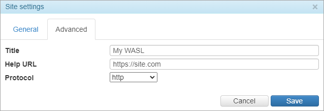

Wasl
The advanced settings of the Wasl site don’t influence the available functions. Filling in the fields is optional.
