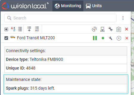

The “Monitoring” tab
All the created service intervals and their execution state can be shown in the unit tooltip and in the extended unit information on the Monitoring tab.
To see them, enable the Maintenance state option in the user settings.
