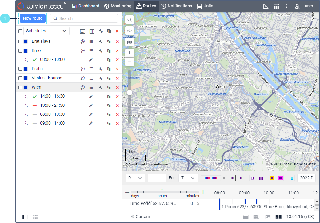

To create a route, follow these steps:
  1. Click New on the Routes tab.

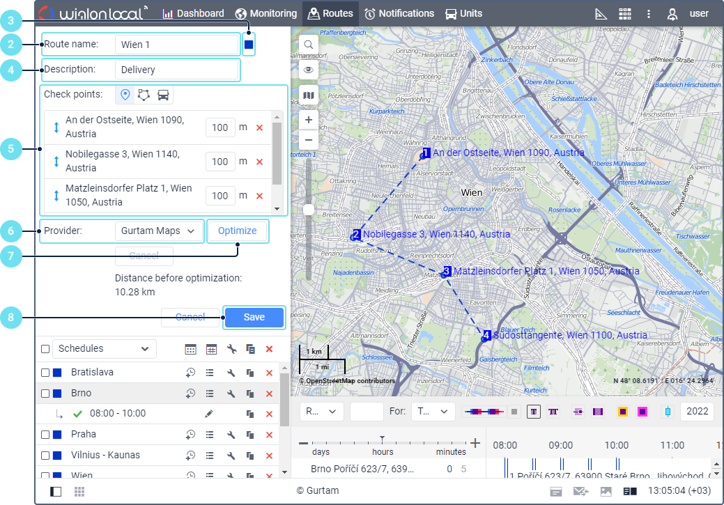

  2. Specify the route name.
  3. If necessary, select the route color.
  4. If necessary, add a description.
  5. Add the check points of the route in one of the ways described below.
  6. Select the routing source.
  7. If necessary, enable the route optimization.
  8. Click Save.

Adding check points
The following ways of adding check points are available:
ActionDescription
Add check points from map
To add points, follow these steps:
  1. Click Add check points from map.
  2. Select the address source.
  3. Start entering the required address (see more about the Address tool) and select it from the drop-down list or specify the required address by double-clicking on the map.
  4. In necessary, change the address name in the Address field. After saving the point, this action is not available. If there are available geofences at the specified address, they are listed below the Address field.
  5. Click Add as check point.

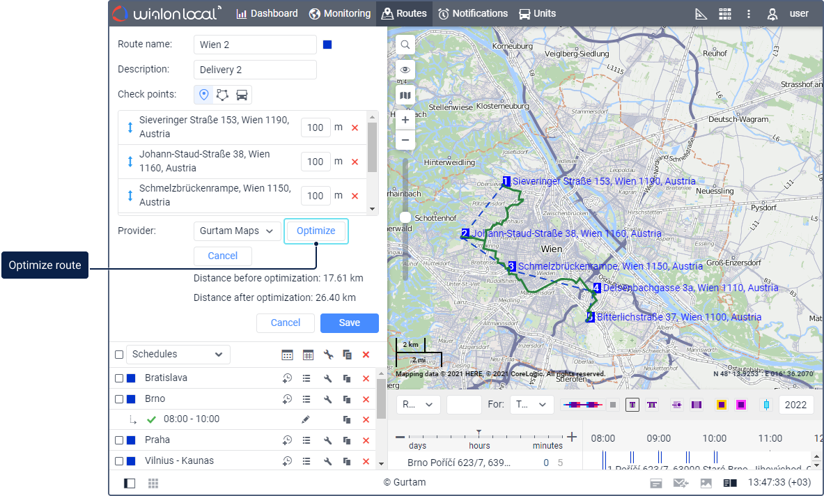

Optimizing routes
Optimization is available if the route has more than two points.
Before saving the route, you can optimize it to determine the most suitable order to go through all the added points. For example, this feature can be useful when creating routes for courier services.
The default map source used for route optimization is Gurtam Maps. However, you can select other sources: Google, HERE, Regional, Sygic, Trimble.
To optimize the route, select the map source and click Optimize. After that, you can see the route length before and after the optimization.
To return to the original route, click Cancel.
