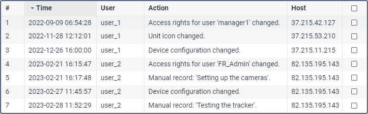

When you request messages of the Log type, you can see a table which looks as follows:
The table columns are described below.
Column
Description
Time
The date and time the change was made.
User
The name of the user who made the change or the record.
Action
The description of the change.
You can filter the table content by description.
Host
The address of the computer from which the user made the change. If the word notification or job is written in the column, it means that the action was carried out automatically by the system.
