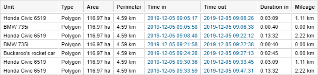

A template for the report on geofences and groups of geofences can contain a table of one type only: the Units table.
The Units table shows the information about what units visited the geofence or group of geofences, at what time they did it, how long they stayed there, at what speed they moved, etc.
The Units table can include the columns described below.
