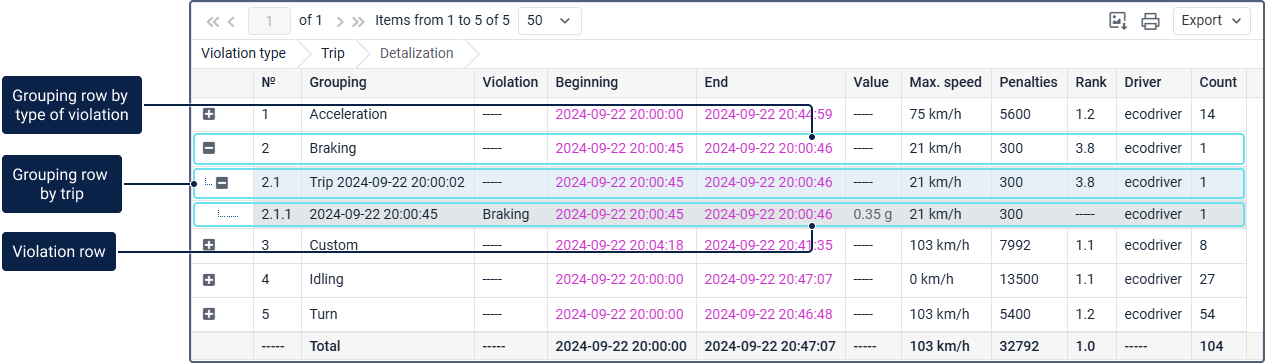

Grouping rows in the “Eco driving” table
You can add grouping by violation type, trip, engine hours, violation duration, day, month, etc. When using grouping, you should enable detalization to view the rows that are included in the group.
The same violations can enter into several grouping types at the same time. For example, when you group violations by violation type and by trips and several violations of the same type are determined within the trip, the table has three levels. The violation type grouping includes trip grouping and the detailed violations in the lowest third level. The values in the two grouping columns above violations can be summed up or shown according to the column logic. The details on the information in the columns with grouping and the columns without grouping are described in the table above.
If grouping by trip is applied and violations are determined outside trips, these violations are automatically added to a separate grouping row Outside trips.
If grouping by engine hours is applied and violations are determined outside engine hours, these violations are automatically added to a separate grouping row Outside engine hours.

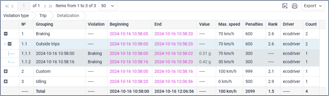

Why are there violations outside trips?
If a violation interval falls in this grouping row, it means that the trip detector is set incorrectly or the wrong grouping type is selected. For example, when an overhead crane is working, the engine is running, but no trips can be detected because the unit is not in motion. If the table is grouped by trips and a violation is detected for this unit, it falls to the Outside trips row.
The example below shows the violations that have been determined outside the trip because of the incorrect settings of the trip detector.

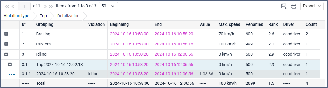

Why are there violations outside engine hours?
If a violation interval falls in the Outside engine hours grouping row, it means that the sensor settings are incorrect or the wrong grouping type is selected. For example, engine hours can’t be found when none of the following sensors are configured: engine ignition sensor, absolute engine hours sensor, relative engine hours sensor. If grouping by engine hours is set and a violation is detected, it falls into the Outside engine hours grouping.
