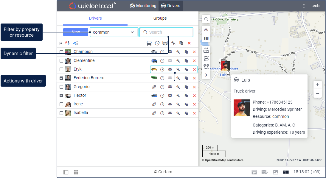

To quickly find the required driver, use the following filters:
  • filter by property (assigned or not assigned drivers) or by resource,
  • dynamic filter by driver name, phone or code.
Tooltip content
In a driver tooltip, you can see the driver name, description, enlarged photo, phone number, custom fields (if specified), the name of the unit to which the driver is assigned, and the resource to which the driver belongs.

Actions with drivers
You can perform the following actions with drivers:
Icon Action
Assign the driver to a unit. If you don’t have the Create, edit, and delete drivers access right, the icon is inactive (). When the driver is assigned to the unit, the unit icon is displayed instead of this one. When you point to the unit icon, you can see the unit tooltip and the icon for separating the driver from the unit.
View the assignment history, add or delete records from it.
Send the driver an SMS message to the phone number specified in the driver properties. The icon is inactive if the requirements for sending SMS from the monitoring system are not met or the phone number is not specified in the driver properties.
/ View or edit the driver properties.
Copy, that is, create a new driver using this one as a template.
red cross icon Delete the driver. The icon is inactive if you don’t have the Create, edit, and delete drivers access right.
