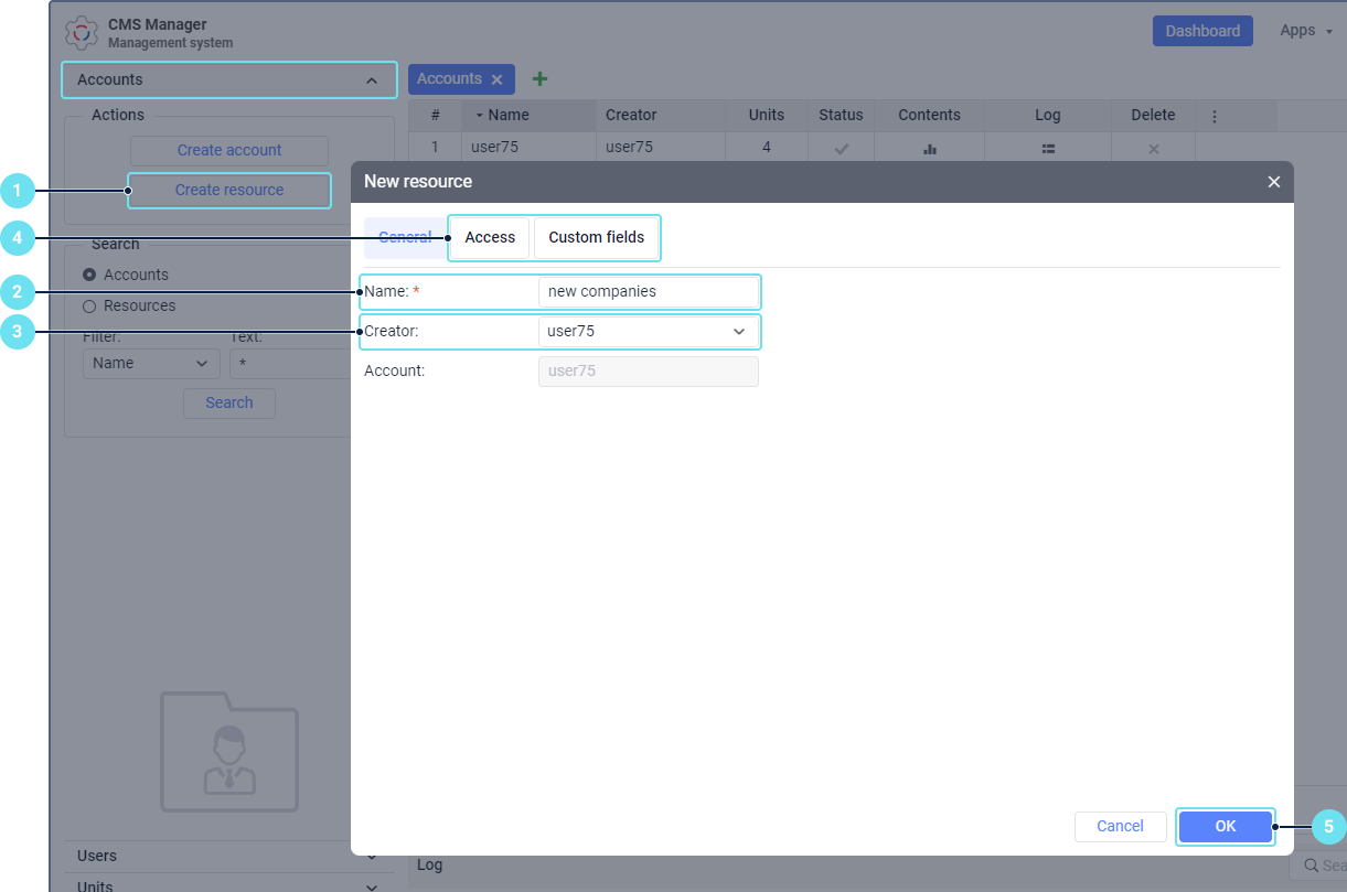

To create a resource, follow the steps below.
  1. Click on the Create resource button in the Accounts section.
  2. Specify the name of the resource (4–50 characters). It should be unique in the system. When filling in this field, consider the input rules.
  3. Select the creator of the resource. After saving the resource, you cannot change this property. The creator of the resource has all access rights to it.
  1. If necessary, configure the Access and Custom fields tabs.
  2. Click ОК.
By default, the measurement system applied to the resource is the same as the one specified for its creator. If necessary, you can change it using conversion.
To see the created resource in the list, activate the Resources switch in the Search block and click on the Search button.
