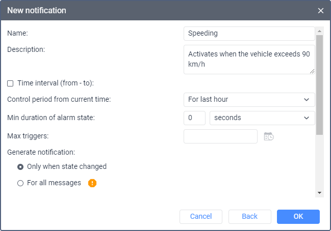

At the last stage of creating a notification, you should specify the parameters for its triggering.
Depending on the selected notification type, the parameters described below may be available. The required parameters are marked with an asterisk (*).
Parameter Description
Name* The name of the notification. When filling in this field, take input rules into account.
Description The description of the notification. If added, it is used in the notification tooltip. The text should not contain more than 10,000 characters.
Time interval (from — to) The validity period of the notification. By default, it is unlimited, that is, the notification becomes active immediately after it is enabled and until it is disabled or deleted. To set a specific validity period, activate this option and specify the time frame. After the specified interval expires, the notification is automatically disabled or, if the controlled units do not exist any more, deleted.
Control period from current time* The period between the time when the message was generated by the device and the time when it was registered on the server (see the table of data messages). If this value is exceeded, the message is not taken into account and the notification is not triggered.
For notifications of the Fuel drain and Fuel filling or battery charge type, this parameter refers to the interval between the time of a filling,drain or battery charge (time of the maximum fuel or battery level difference) and the moment of their registration in real time.
It is advisable to indicate a control period of at least an hour because a shorter period may not be enough for data analysis.
Min duration of alarm state* The parameter which allows you to prevent the accidental triggering of the notification caused by tracker errors (for example, in case of false exits from the geofence). You can also use this parameter, for example, to specify the minimum duration of speeding or other alarm states for which a notification should be triggered.
Specify the minimum duration of the alarm state in seconds, minutes or hours and select a unit of time in the drop-down list. The maximum allowed value is 24 hours (1440 minutes, 86,400 seconds).
Max triggers The maximum number of times the notification can be triggered. When this limit is reached, the notification is automatically disabled.
The option is applied to all notification triggers of all the units or unit groups controlled by this notification. For example, 5 is indicated in the Max triggers field of the notification that controls 2 units. The notification is disabled when the sum of triggers for both units reaches 5.
You can set a time limitation for this parameter (icon ). In this case, the limit on triggers is applied only to the specified intervals, that is, the notification can be triggered any number of times outside of these intervals.
Generate notification* The parameter which allows you to select when the notification should be triggered. Two options are available: For all messages and Only when state changed.

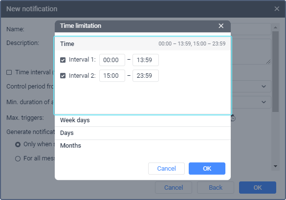

Time limitation
To set a time limitation, follow the steps below.
  1. Click on the icon  .
  2. Specify the time limitations in the sections described below.
    To expand a section, click on it.
    Section Description
    Time Specify, during what time interval the notification parameters should be controlled within the day. You can specify two time intervals.
    The last minute of the specified interval is included in the limit. For example, specifying a time limit of 00:00 to 13:59 will include an interval of 13:59:00 to 13:59:59.
    To make the interval fields active, check the box next to them.

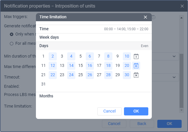

    Week days Select the days of the week on which the notification parameters should be controlled.
    Days Select the dates on which the notification parameters should be controlled. To select all the odd or even dates at once, click on the icon or , respectively. To clear the selection, click on the icon .
    Months Select the months during which the notification parameters should be controlled.
  3. Click OK to apply the limitation. To close the window without saving the changes, click on the icon  or select Cancel.
If you specify a limitation only in the Time section, the notification parameters are monitored during the specified intervals every day. If you select days and months in addition to the time intervals, the system controls the notification parameters during the specified intervals only on these days and months. If you specify a limitation only in the Months section, the notification parameters are constantly monitored during the selected months.
