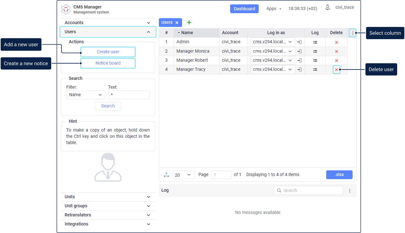

You can work with users in the monitoring system (the Users tab) and in the management system (the Users section).
The table of the Users section contains all the available users. Here you can perform the following actions with them: creating, copying, viewing or editing properties, deleting. To find users quickly, use the dynamic search.
Selecting columns
To hide or show columns, click on the icon in the table heading. In the menu, the following columns are available:
ColumnDescription
#The sequence number of the user in the table.
NameThe name of the user in the system specified in the general properties.
CreatorThe user on whose behalf this user is created.
AccountThe account to which the user belongs.
Billing planThe billing plan assigned to the account to which the user belongs.
Last visitThe date and time of the last login to the system.
Log in as
The drop-down list of sites available for the account to which the user belongs. You can select the required site on the line of the user and log in to it on behalf of this user by clicking on the icon .
To log in to the site on behalf of another user, you should have the Act on behalf of this user access right to this user.
The name of the user on whose behalf you log in to the site is shown in brackets to the right of the name of the main user. To return to the main user, click on the icon and confirm the action in the window that opens.
Log
The icon which allows you to open the log of the user.
Delete
The icon  which allows you to delete the user. If you don't have access rights to delete the user, a dash is displayed instead of the icon. See more information about the peculiarities of deleting users here.
