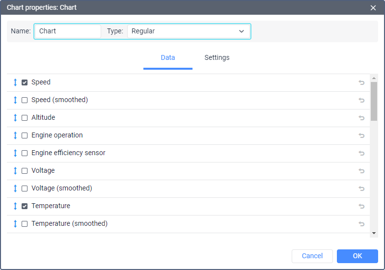

To add a chart to the report template, click on the New chart button on the Report Contents tab of its properties.
Charts can only be added to reports of the Unit and User type.
In the dialog for creating a new chart, specify its name and select the type.
Next, specify the chart properties on the Data and Settings tabs.
