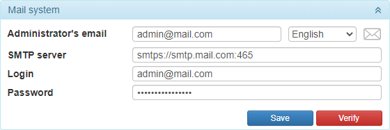

In the Administrator’s email field of this section, enter an email address where you want to receive system notifications about available updates, occurring errors, insufficient disk space, and so on.
In the drop-down list to the right of the email, select the language in which system notifications to the administrator should be sent (English, Russian, or Spanish).

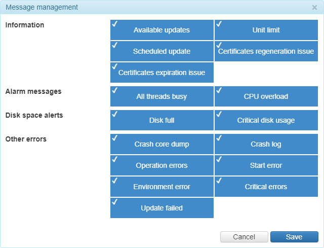

To customize the content of administrator notifications, click on the icon . Next, select the required subjects and click Save.
The additional software installed together with the Debian operational system includes the Postfix email agent configured specially for Wialon Local. It is used for sending email messages from the system (sending notifications about Wialon Local operation to the administrator, sending reports to the end users, resetting passwords, and so on).
If you want to use Postfix, it is advisable to leave blank all fields except the Administrator’s email and then configure the required settings in Postfix.
If you want to use an SMTP server other than Postfix, fill in the SMTP server, Login, and Password fields.
For notifications to the administrator, noreply@noreply.com is used as the sender address. If the SMTP server is configured, the email address indicated in the Login field of the Mail system section is used as the sender address.

  1. In the SMTP server field, enter your SMTP server address. When using a non-standard port, enter it in the host:port format. It might be enough if you have your own SMTP server. However, if you use an external server for sending emails, authorization is required. In this case, complete the Login and Password fields with the login and password obtained in this mail system.
  2. Click Save to confirm the changes. Do not restart Wialon Local. In this case, the settings are applied only to the notifications for the administrator.
  3. Click Verify to make sure the mail system is configured properly. After that, a test message is sent to the administrator’s email. You can see the verification results in the log below.
  4. If the verification is successful, restart Wialon Local (click Stop and then Start) to apply new settings to all emails.

  1. In the Administrator’s email field of the Mail system section, enter an email address to which notifications for the administrator should be sent.
  2. In the SMTP server field, enter smtps://smtp.gmail.com:465.
  3. In the Login field, specify the email address of a Google account.
  4. In the Google account settings (Manage your Google Account → Security → Signing in to Google), enable 2-step verification if it is not activated.
  5. In the Google account settings, create a password for the Mail app in the Manage your Google Account section (App passwords → Select app → Mail → Generate).
  6. In the Mail system section in the administration system of Wialon Local, complete the Password field with the password created in the Google account for the Mail app.
  7. Click Save without restarting Wialon Local. In this case, the settings are applied only to the notifications for the administrator.
  8. Click Verify and make sure that a test message has been sent to the email address indicated in step 1.
  9. If the verification is successful, restart Wialon Local (click Stop and then Start) to apply new settings to all emails.
