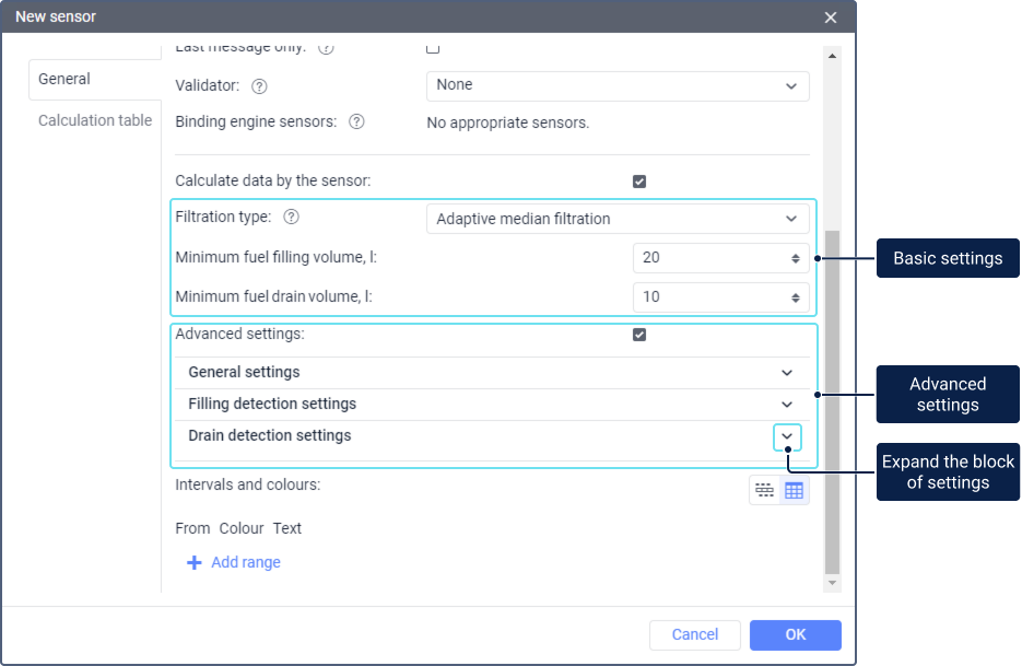

Basic settings
The basic settings of the fuel level sensor include three options.
Filtering type
This option allows smoothing the sensor values to avoid data outliers (sudden changes in the fuel level: rises or falls).
Filtering of FLS values is taken into account in reports (in tables and charts when displaying smoothed lines), in jobs for sending fuel level information, and in notifications about fuel fillings and drains.
The drop-down list contains three items:
Item Description
None Select this item if the data doesn’t require filtering.
Median filtering If you select median filtering, you should specify its level, that is, how much the data should be smoothed. For information about this type of filtering and the selection of a suitable filtering level, see Median filtering of FLS values.
Adaptive median filtering If you select adaptive median filtering, no additional settings are required. The algorithm automatically selects a suitable value based on the unit data.
The algorithm smoothes small random fluctuations in fuel level without affecting significant variations. This allows detecting fuel fillings and potential drains more efficiently and determining their volume more accurately.
Minimum fuel drain volume
The minimum decrease in the fuel level which should be considered a drain. The value of this field should be greater than 0 and can be fractional.
Minimum fuel filling volume
The minimum increase in the fuel level which should be considered a filling. The value of this field should be greater than 0 and can be fractional.
Advanced settings
The system uses default values for the advanced settings, but you can change them if needed. To do this, activate the Advanced settings option and edit the values in the General settings, Filling detection settings, and Drain detection settings blocks. If the Advanced settings option is deactivated, the edited values are replaced by the default ones.
General settings
Calculate fillings by time
This calculation method is recommended for units with high fuel consumption at idling (generator, tower crane, etc.). When this option is activated, all time intervals are included, regardless of trips/stops.
Detect fuel fillings only during stops
When this option is enabled, fillings are detected only at stops, that is, when the speed of the unit is lower than the minimum one indicated in the trip detection. This allows reducing the number of false fillings which are caused, for example, by fluctuations in the fuel level during movement.
The initial fuel level is taken from the first message without movement or from the last message with movement.
If any value is indicated in the Timeout to detect final filling volume field, the fillings are also detected during this time after the stop ends.
This field becomes available when the previous option is activated. Here you can indicate the duration of interruptions between fuel entries in the process of filling. To determine the fuel level after the filling, the message that follows the indicated timeout is used, but not the last one that corresponds to the filling. To determine the filling volume, the system calculates the difference between the fuel level from this message and the message that precedes the start of the filling.
Calculate filling volume by raw data
This option can be useful if you set a high level of median filtering for smoothing the outliers of FLS values. As a result of such filtering, the values of the initial and final fuel level and of the filling volume are distorted. Under certain conditions, the option allows replacing them with the values calculated on the basis of raw data, that is, the data before smoothing. The filling interval itself, though, is calculated on the basis of the smoothed data.
If this option is enabled, the system uses the following algorithm:
  • The filling volume (Vfilled) is calculated according to the formula:
    Vfilled= Vmax—  Vmin,
    where:
    Vmax  is the maximum fuel level within the filling interval according to the raw data;
    Vmin  is the minimum fuel level within the filling interval according to the raw data.
    Vmin is also considered to be the initial fuel level within the filling interval. To calculate the final level within this interval, the filling volume (Vfilled) is added to the initial level.
  • If the resulting value of the filling volume exceeds the volume calculated on the basis of raw data, the values of the initial and final level and of the filling volume are replaced with the new ones. Otherwise, the values remain the same.
Timeout to separate consecutive fillings
If this option is enabled and more than one filling within a short time interval is detected, the fillings are combined into one, provided that the time between them (timeout) does not exceed the time indicated in this setting.
You can get information on fillings by executing the Fuel fillings report, using the Send fuel information by email or SMS job or the notification about fuel fillings.
Calculate drains by time
It is similar to the Calculate fillings by time option (see above).
Detect fuel drains in motion
This setting becomes available only after activating the previous option. The setting allows detecting drains not only during stops, but also during movement, which can be useful, for example, for ships. However, in many cases, activating this option can result in the detection of false drains due to changes in fuel level, for example, while driving on rough terrain.
Minimum stop duration to detect a fuel drain
This setting is available only if the Detect fuel drains in motion option is disabled. Here you can specify the minimum duration of the interval without movement which is followed by a decrease in the fuel level by more than the minimum fuel drain volume indicated in the basic settings.
Calculate drain volume by raw data
It is similar to the Calculate filling volume by raw data option (see above).
Timeout to separate consecutive drains
If this option is enabled and more than one drain during a short time interval is detected, the drains are combined into one, provided that the time between them (timeout) does not exceed the time indicated in this setting and the fuel level has not increased.
You can get information on drains by executing the Fuel drains report, using the Send fuel information by email or SMS job or the notification about drains.

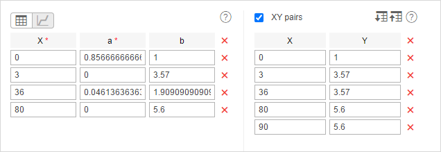

How to determine fuel consumption, if I know how much fuel the unit consumes within the city, and how much outside it?
Let us suppose that the fuel consumption in the urban cycle is 10 l/100 km and 7 l/100 km — in the suburban cycle.
  • Create an ignition sensor (as in the example above) and set 1 l/h for the consumption during idling.
  • The average consumption in the urban cycle is 36 km/h, in the suburban — 80 km/h.
  • The unit will cover a distance of 100 km driving at a speed of 36 km/h in 2.8 hours. 10 l / 2.8 = 3.57. Let us calculate the value of the increasing coefficient when moving in the city: 3.57 / 1 (idling) = 3.57.
  • As a result of a similar calculation for the suburban cycle, we obtain the coefficient equal to 5.6.
  • Create an engine efficiency sensor, taking into account the fact that the unit cannot consume less fuel than during the idling, and that it is stationary before the beginning of the movement. As a parameter we use the average speed (speed + # speed) / const2 and fill in the calculation table (manually or using the calculation table wizard):
Note that the last pair of points is how the system calculated before (the fuel consumption was considered constant for a speed above 80 km/h). You cannot use this method and change the set of points. Also ‘3’ in this example is the minimum speed from the unit’s trip detector, consequently, this parameter can be different for your unit.
Result: in our example, the average consumption has been calculated for the unit. It has been calculated relative to the speed and time between messages and taking into account the values of the vehicle operation.
