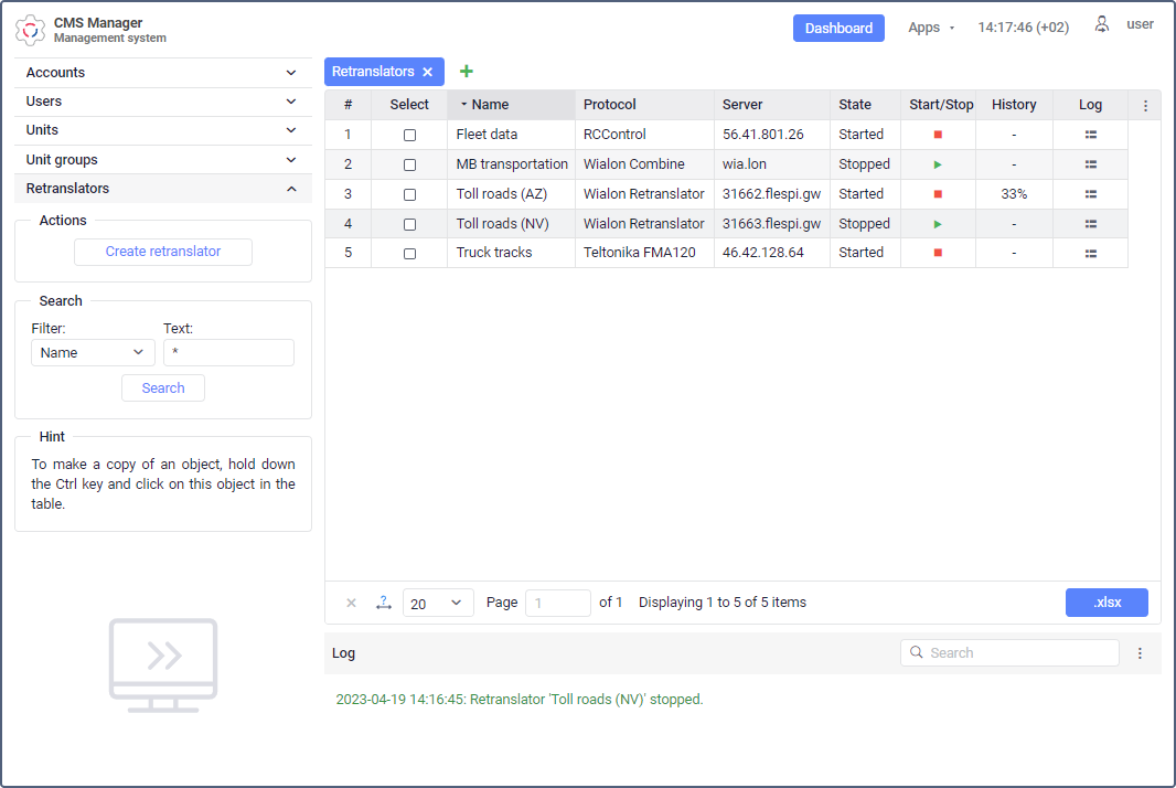

You can work with retranslators only in the Retranslators section of the management system. Here you can perform the following actions with them:
To find a retranslator quickly, use a dynamic search.
The table of the section contains all the created retranslators. You can select table columns in the menu that opens after clicking on the icon  in the table header. The following columns are available in the menu:
Column Description
# The sequence number of the retranslator in the table.
Select The checkbox for selecting the retranslator.
Name The name of the retranslator.
Creator The user who has created the retranslator.
Account The account in which the retranslator has been created.
Protocol The protocol using which unit messages are transmitted to another server or system.
Server The server to which unit messages are transmitted.
Status The state of the retranslator: started or stopped.
Start/Stop The icon for starting (play.png) or stopping (stop_stream.png) the retranslator. The same button is available in its properties.
History When transmitting data for a past period, this column shows the percentage of units for which data transmission has already ended.
Log The icon which opens the retranslator log.
You can sort the data in the table by any column. To do this, click on the column header.

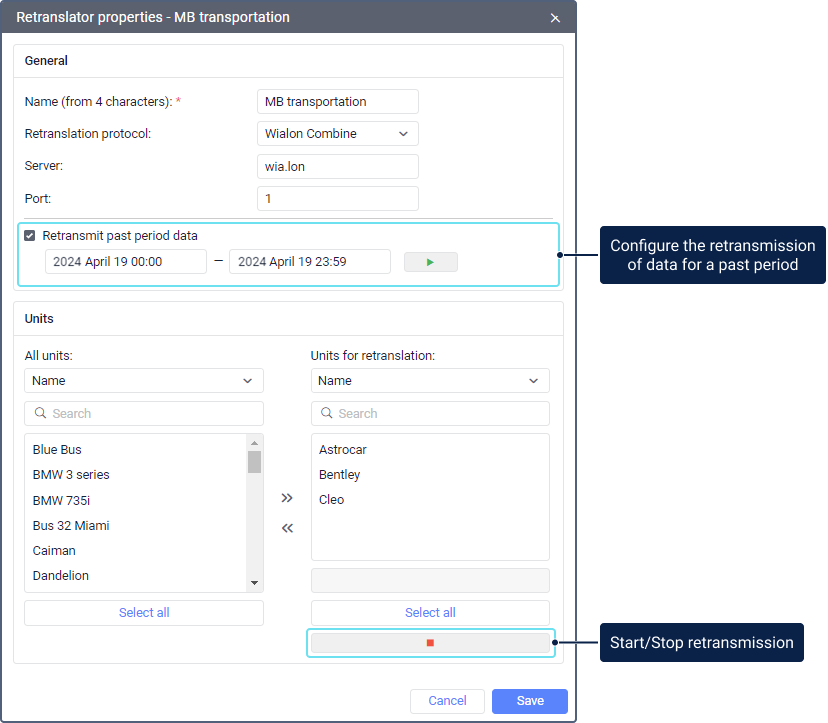

Retranslator properties
To open the properties of a retranslator, click on its row. The window of the properties is similar to the retranslator creation window. The only difference is that the properties contain the Retransmit past period data option, as well as the button /  for starting and stopping data transmission.

Retransmitting data for a past period
To transmit unit messages for a past period, follow these steps:
  1. In the retranslator properties, enable the Retransmit past period data option. The option is available only if the retranslator is started.
  2. Specify the period for which you want to transmit data.
  3. Click on the button  to the right of the specified period.
The percentage of units for which data transmission has already ended is shown in the History column of the retranslator table.
