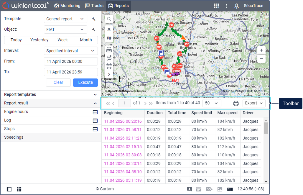

Toolbar
A report table can contain up to 100,000 rows, therefore, it is divided into pages. To navigate between pages, use the navigation buttons on the left side of the toolbar:
  • : go to the next page;
  • : go to the previous page;
  • : go to the first page;
  • : go to the last page.
To go to a specific page, enter its number in the Page field and press Enter. You can also adjust the number of rows per page by selecting one of the options (25, 50, 100, 200, 500) from the drop-down list to the right of the navigation buttons.

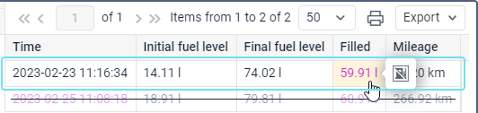

Sometimes filling or draining may be detected by mistake, for example due to incorrect equipment settings or fluctuations in the fuel level in the tank. You can hide such fillings and drains by marking them as false events in the Fuel fillings and battery charges and Fuel drains tables.
To do this, do the following:
  1. In the completed report, locate the row that contains the erroneously defined filling or drain.
  2. In this row, click on the cell in the Filled or Drained column where the amount of fuel filled or drained is calculated. Then the icon or  is shown next to the cell.

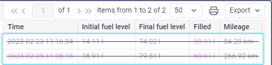

  3. Click this icon. A table row with a false event is indicated by a strikethrough font and a blurred background if the Show false events option is enabled.
    If this option is disabled, the row with the false event is hidden.
  4. Click Execute on the Reports tab again to have the system recalculate the values.
As a result, the data on fillings and drains marked as false are excluded from the report tables. In particular, the number of fillings and drains, as well as the volume of drained, filled and consumed fuel in the tables of fuel reports and Statistics are recalculated.

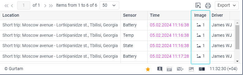

Viewing images
You can add the Image column to some report tables in order to see the images received from units. The column displays the number of images and the icon for viewing them ().
To see an image, click on the icon .
