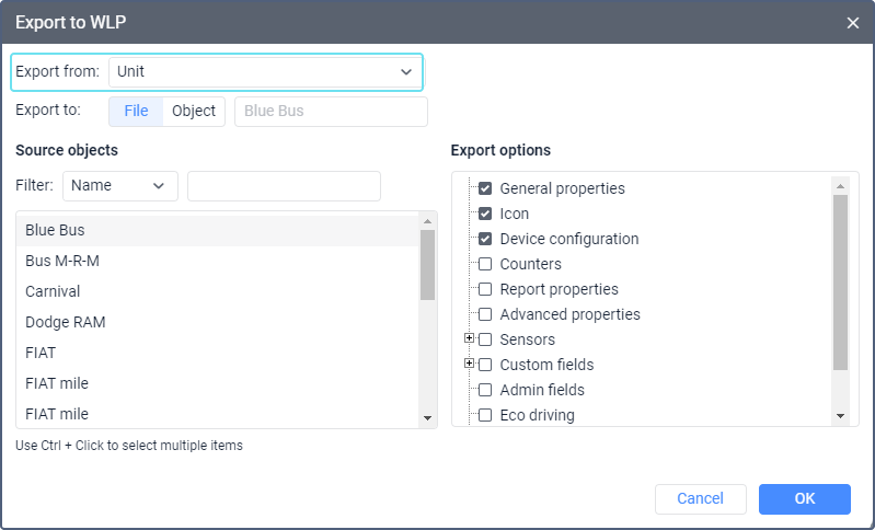

You can copy most of the properties from one unit to another or save them to a WLP file using the import and export tool. The exceptions are:
  • user access rights;
  • unit group membership;
  • information about the creator and the account.
To export unit properties, select the Export to WLP item in the user menu and select Unit in the Export from drop-down list. See a detailed guide here.
To add the properties of one unit to another using a WLP file, select the Import from WLP item in the user menu and follow the guide.
Exportable properties
Below are the unit properties you can export.
