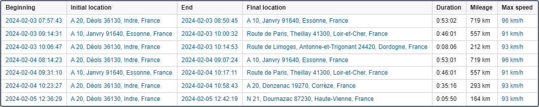

Trips
The Trips report shows the intervals of movement with the indication of time, location, and other parameters such as speed, mileage, fuel, and many others. The intervals of movement (trips) are detected according to the parameters set on the Trip detector tab and adjusted for each unit individually.
The table can include the columns described below.
Column Description
Beginning The date and time when the trip began.
Initial location The address where the device was at the beginning of the trip.
Initial coordinates The geographical coordinates of the location of the unit at the beginning of the trip (in decimal degrees).
End The date and time when the trip ended.
Final location The address where the unit was at the end of the trip.
Final coordinates The geographical coordinates of the location of the unit at the end of the trip (in decimal degrees).
Driver The name of the driver (if assigned).
Trailer The name of the trailer (if assigned).
Passengers count The number of passengers transported within a trip.
Duration The time interval of the trip.
CO2 emissions The amount of CO2 emissions during the trips. It is calculated by multiplying the value in the Mileage in trips column by the value specified on the Profile tab in the unit properties.
Total time The time from the beginning to the end of trip. It is recommended to use this column in combination with the grouping parameter or the Total row. If the Total row is configured in the table, it shows all the time that elapsed from the start of the first trip to the end of the last one.
Off-time The period of time passed from the end of the previous trip to the beginning of the current one (defined beginning from the second trip).
Following off-time The period of time passed from the end of the current trip to the beginning of the next one.
Engine hours The time of the operation of engine hours during the trip.
Mileage The distance travelled by the unit during the whole trip.
Mileage (adjusted) The mileage taking a coefficient set in unit properties (the Advanced tab) into account.
Urban mileage The distance travelled in the urban area.
Suburban mileage The distance travelled in the suburban area (that is at high speed). The urban/suburban speed line is indicated in the Unit properties on the Advanced tab (the Urban speed limit setting).
Initial mileage The value of the Mileage sensor at the beginning of the trip.
If there are no values of this sensor within the interval for which the report is being executed, the initial mileage value is calculated using the counter from the beginning of the interval to the first trip. In this case, the count starts from 0.
If the sensor has sent a message with data not included in the scope of the trip, but included in the interval for which the entire report is being executed, the mileage value is calculated by the counter with consideration of the mileage sensor data.
Final mileage The Mileage sensor value at the end of the trip. The value is calculated based on the initial mileage.
Toll roads mileage The distance that the unit passed during the trip on the roads on which the Platon system is used.
Toll roads cost The sum of money (in RUB) for the toll roads mileage calculated on the basis of the covered distance and the Platon tariff.
Avg speed The average speed within the trip.
Max speed The maximum speed registered within the interval.
Trips count The number of trips at the interval (can be useful if you have enabled grouping by years/months/weeks/days/shifts or if you run the report for a unit group).
Counter The counter sensor value.
Initial counter The counter value at the beginning of the trip.
Final counter The counter value at the end of the trip.
Avg engine revs The average rate of engine revolutions.
Max engine revs The maximum rate of engine revolutions.
Avg temperature The average temperature value registered in a trip.
Min temperature The minimum temperature value registered in a trip.
Max temperature The maximum temperature value registered in a trip.
Initial temperature The temperature value at the beginning of a trip.
Final temperature The temperature value at the end of a trip.
Status The unit status registered during the trip. It can be registered manually or automatically by means of a notification. If there are several registered statuses, the first of them is displayed.
Cargo weight The average value of cargo weight during the trip.
Messages count The number of messages that formed the trip.
Consumed The volume of consumed fuel detected by any sort of fuel sensor. If several such sensors are available, their values sum up.
Consumed by ImpFCS/AbsFCS/InsFCS/FLS/math/math for FLS/rates The volume of consumed fuel detected by a fuel sensor or calculated by math or rates.
Rates deviation by ImpFCS/AbsFCS/InsFCS/FLS The difference between consumed fuel detected by a sensor and consumption rates. If a number in this cell is negative, it means the detected consumption does not exceed the indicated rates.
Avg consumption The average fuel consumption by any sort of fuel sensor. If several such sensors are available, their values sum up.
Avg consumption by ImpFCS/AbsFCS/InsFCS/FLS/math/math for FLS/rates The average fuel consumption during the trip detected by one of the methods mentioned above.
Avg consumption in idle run by ImpFCS/AbsFCS/InsFCS/FLS/math/math for FLS/rates The average fuel consumption during the idle run.
Avg mileage per unit of fuel by ImpFCS/AbsFCS/InsFCS/FLS/math/math for FLS/rates The average mileage (per one liter/gallon) detected by one of the methods mentioned above.
Initial fuel level The fuel level at the beginning of the trip.
Final fuel level The fuel level at the end of the trip.
Max fuel level The maximum fuel level during the trip.
Min fuel level The minimum fuel level during the trip.
Penalties The penalties calculated for the adjusted Eco driving criteria.
Rank The received penalty points converted into a grade using a 10-point scoring system.
Avg value of custom sensor The average value of a custom sensor during the trip.
This and the following columns of custom sensor values show 0 if the value is invalid. For example, if the value is not within the bounds set in the calculation table.
Min value of custom sensor The minimum value of a custom sensor during the trip.
Max value of custom sensor The maximum value of a custom sensor during the trip.
Initial value of custom sensor The custom sensor value at the beginning of a trip.
Final value of custom sensor The custom sensor value at the end of a trip.
Notes An empty column for your custom comments.
Image The images received from the unit. Viewing images in reports and the functions available while doing this are described here.
The availability of the Toll roads mileage and Toll roads cost columns is stipulated by a special service. Contact your service provider if you want to use this functionality.
See data in reports to find more about formatting time, mileage, fuel, etc.
Also, the interval filtering by duration, mileage, engine sensor, engine hours, speed range, stops, sensors, driver, trailer, and geofences/units can be applied to this table.
The tracks of the trips can be displayed on the map. To make use of this feature, in the report template, select the options connected with the rendering of tracks on the map.
